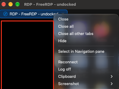

I looked into it a bit more, and if you have set this setting in the file -> setting view
It should select in the tree your undocked entry when you focus it, making the menus apply to it. Unfortunately, changing the behavior of the entry menu would affect other scenarios, such as external entries where RDM cannot know what is focused, so we can't do it. The right click context menu of the tab is the correct way to do actions in a tab.
I see you also mentioned shortcuts, is this what you use to trigger the "Entry - Reconnect" ? If so, I believe we could add a "Actions - Reconnect" shortcut ( or something similar ) that would apply to the current active tab.
