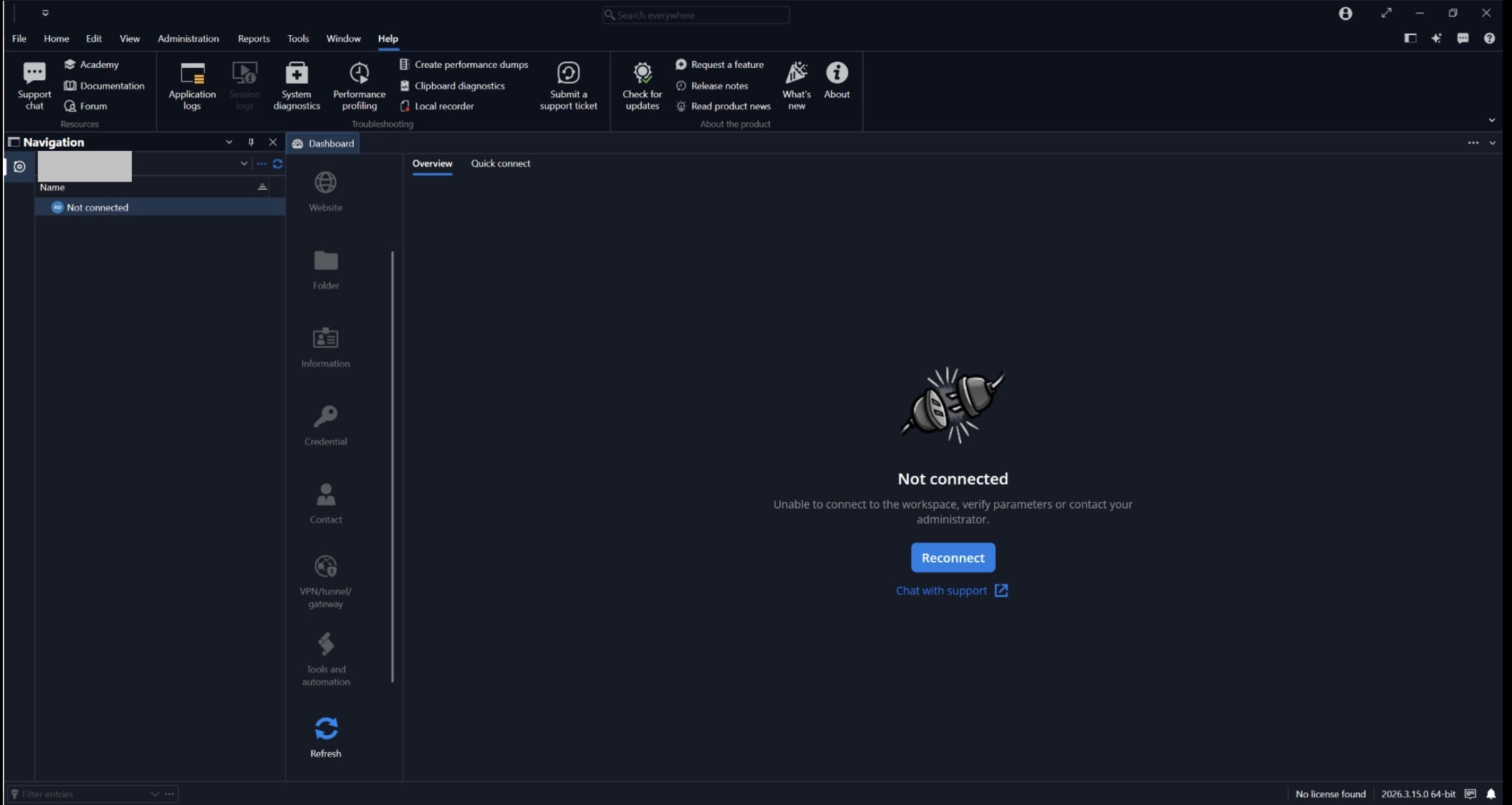

We’ve been experiencing intermittent issues connecting to our Devolutions Server (DVLS) vaults. While these issues were extremely rare in earlier RDM 2026.3 releases, they have become significantly more frequent since upgrading to RDM 2026.3.15.

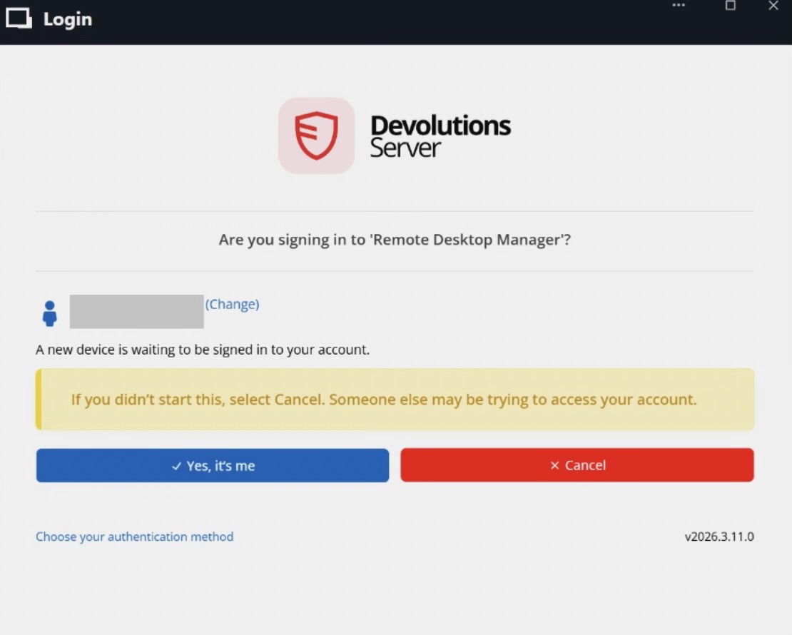

Users are repeatedly encountering authentication prompts asking them to confirm a new device sign-in, along with “Not connected” errors indicating that RDM is unable to connect to the workspace.
Repeatedly closing RDM and then selecting “Yes, it’s me” often results in extremely slow connection attempts, and RDM will sometimes become unresponsive or freeze during the process. Eventually, after multiple attempts or an extended delay, the connection succeeds, and everything works normally afterward. The issue appears to be primarily during the initial authentication and connection process rather than during normal operation once connected.

I’ve attached screenshots showing the repeated authentication prompt and subsequent workspace connection failure.

The "Yes, it's me" confirmation comes from a security change in recent Devolutions Server versions, which fixed a phishing risk in the device sign-in flow. This step can't be turned off, but it should only appear when Remote Desktop Manager needs a completely new sign-in. Normally, RDM restores the previous session at startup using a token saved on the device.
The "Not connected" screen in your screenshot appears when that sign-in doesn't complete. Because your users see the prompt this often, it seems their session isn't being restored, which also explains the slow connection attempts.

When the "Not connected" screen appears, whether clicking Reconnect connects right away or RDM becomes unresponsive
RDM becomes unresponsive. After a few moments (typically a minute or few) it may become responsive again.

This issue matches an existing case that has already been escalated to our development team. The team has implemented a fix, and we are currently awaiting QA validation and the release of a new RDM version.
I have linked the development case to this support case so that you will be notified once the new RDM version containing the fix is released.
In the meantime, I would also recommend updating DVLS to the latest version, as a similar issue on the DVLS side was addressed in version 2026.3.12.0.

I'm happy to let you know that the latest version of Remote Desktop Manager (2026.3.16.0) includes a fix for this problem. You can download it from our website here:

This worked perfectly! Thank you so much!
