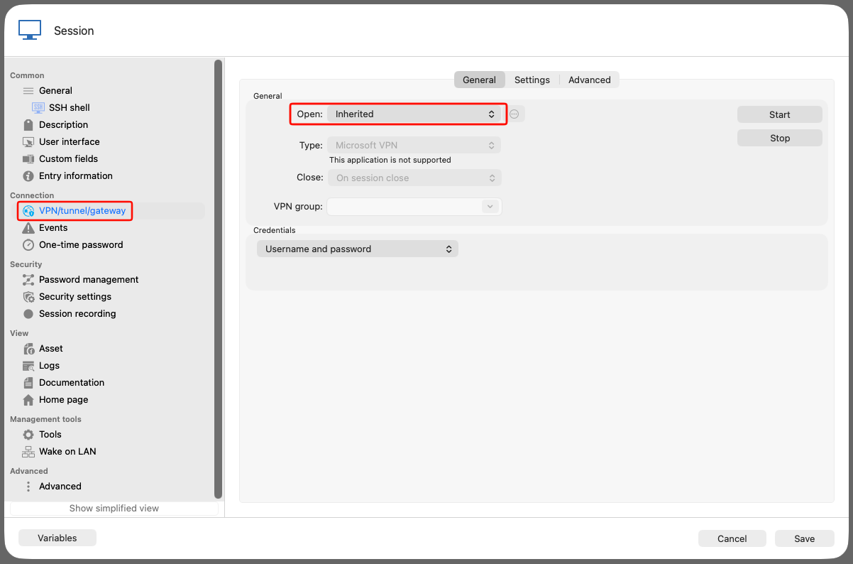

To connect to any of these connections, an SSH tunnel must first be established. To simplify the configuration, all connections and subfolders are set to "Inherited" in the "VPN/tunnel/Gateway" settings:

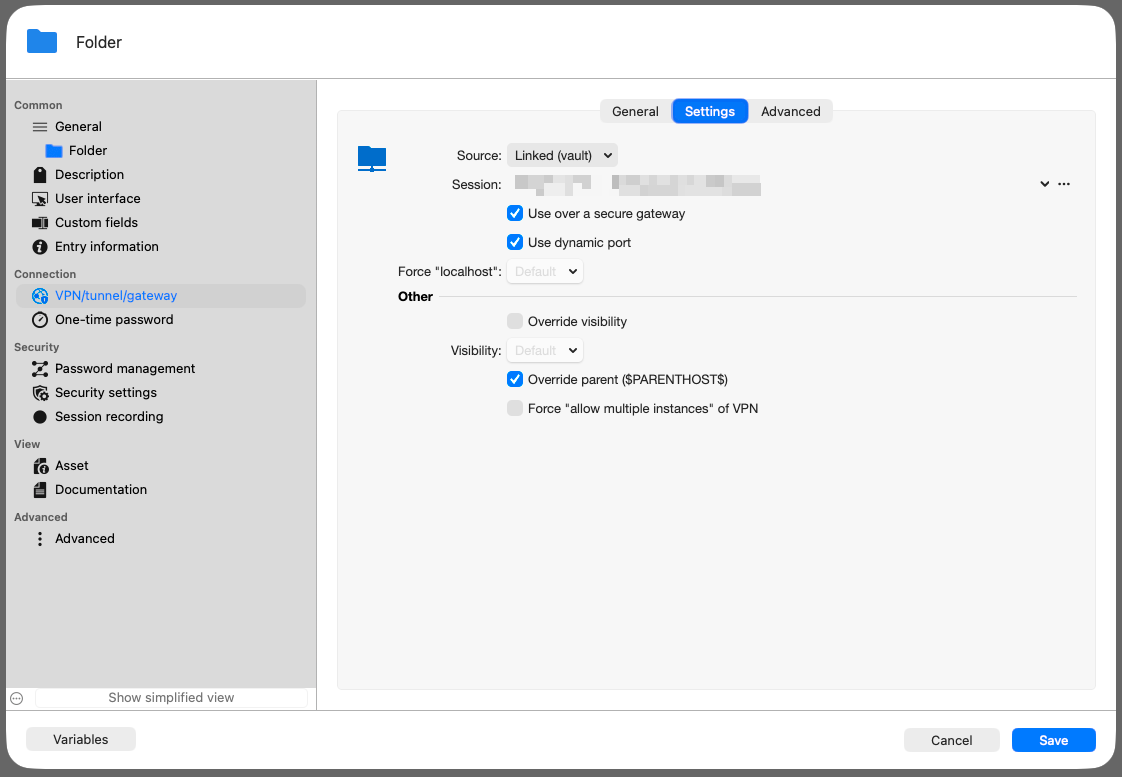

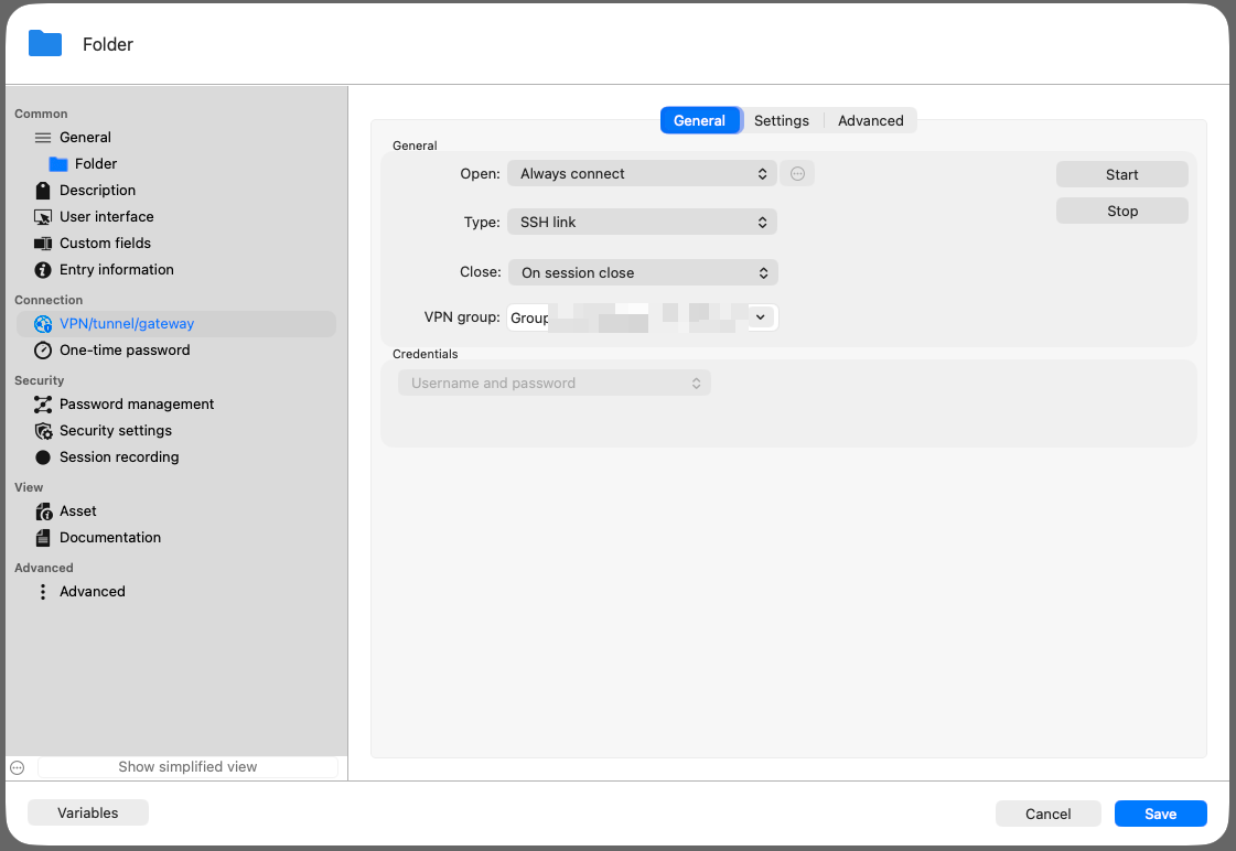

The parent folder (Test folder) is then configured as follows:

Your configuration matches what is expected for this scenario. The VPN group name is set, and Close is set to "On session close" on the parent folder, with the child entries set to Inherited. With this setup, the tunnel should stay open until the last session of the group is closed. What you are seeing does not look like intended behavior.
