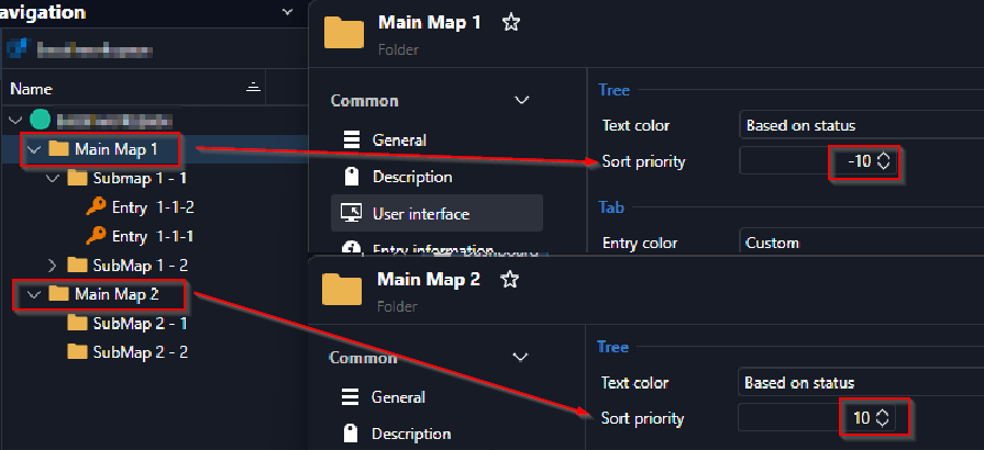

I noticed an issue with the Sort Priority setting for Map entries/folders.
The custom Sort Priority configured under User Interface is not respected when sorting Map entries/folders in the navigation. When using the default sorting based on Sort Priority, I would expect the configured priorities to determine the order of these Map entries.
  • Main Map 1 has a Sort Priority of -10
  • Main Map 2 has a Sort Priority of 10
This seems to apply to all Map entries, including Main Maps and SubMaps.
Interestingly, the Sort Priority is correctly respected for other entry types. This makes it appear that the issue may specifically affect the sorting logic for Map entries/folders.

@Maxim Robert, that appears to have solved the problem, thank you!
For me it's also Fixed, problem Solved.
Thanks
