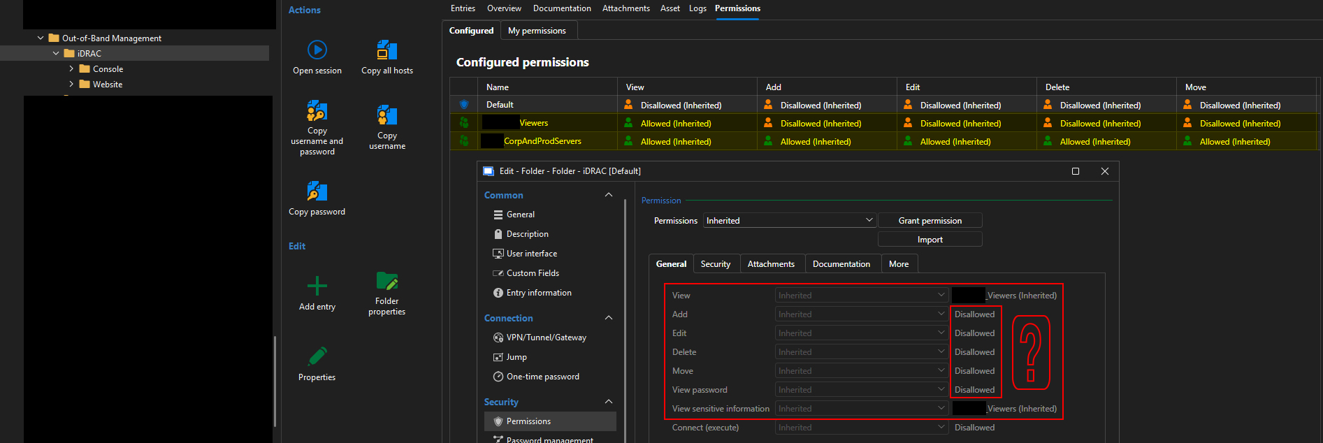

Actually @Carl Marien sorry, maybe I spoke too soon on my earlier reply - something still seems off. I just added some new permissions on a parent folder, set to custom+inherited with some custom group permissions I added, but when I looked at the folders afterwards, it is not showing correctly.
On the child folder under the one where I set the new permissions, I can see the new group being inherited on the dashboard "permissions" tab. Plus, I confirmed with the user in that group that the permission actually did take effect. However, when I right-click that folder and go into its properties -> Permissions page, it does not reflect this - see screenshot below.
I know it might be a little difficult to decipher since I had to redact pieces for security but I tried to leave enough detail to show what I think is wrong - you can see the group whose name ends in _Viewers is shown as inherited in both the dashboard page and in the folder properties - that is the group whose permissions are assigned higher up in the tree. Then the group whose name ends in _CorpAndProdServers is the one that was assigned explicit permissions (using custom+inherited, so it should keep inherited permissions and add on the explicit ones) on this folder's parent. Both of those are reflected in the dashboard's Permissions tab (shown in the background), however only the _Viewers inheritance is shown in the folder's properties (foreground). The permissions outlined in red with the question mark are the ones I'd expect to see showing the _CorpAndProdServers group as having inherited permissions on, but it does not.
This is on v2026.1.24. Any help is appreciated.
David Willis
Hello David,
Thank you for the additional details and the follow-up screenshots. Based on your testing, it looks like the actual permission enforcement is working correctly (the effective access for your user matches what is configured), but there is a display issue in the object's Properties > Permissions page: it is not consistently showing which group a permission is being inherited from when that permission was explicitly customized on a parent folder (as opposed to left at its default state).
We can also see that the Dashboard "Permissions" tab for the same folder correctly reflects the inheritance from the group you added, so the discrepancy appears to be isolated to how the inline inheritance hint is rendered in the Properties dialog, not to the permission logic itself.
To help us confirm and escalate this properly, could you let us know:
  • In your latest screenshot, does the same missing inheritance hint occur only when editing the "Default" entry, or also when you open the entry for the group itself (for example, the _CorpAndProdServers row)?
  • If possible, would you be able to reproduce this on a minimal test folder structure (two folder levels, two groups) so we have a clean, isolated case to pass along for further investigation?
In the meantime, please be assured that this does not appear to affect actual access control, only the informational display in that dialog.
Carl Marien
