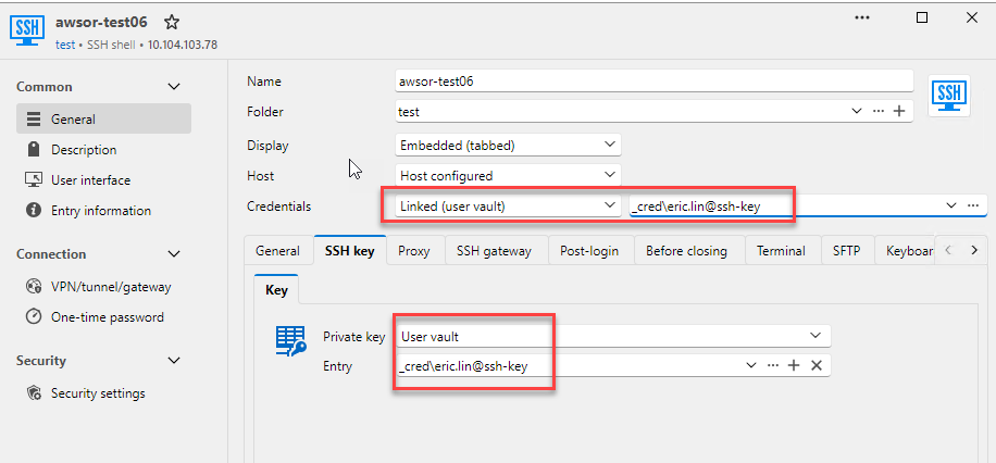

RDM didnt read/carry certificate in SSH Key entity to perform SSH cert-based auth
Resolved
Remote Desktop Manager 2026.3.15.0 64-bit (PreJIT)
RDM Win already support SSH Key (credential) with certificate.
in SSH session, select the SSH Key with certificate installed. Neither the Credential or the SSH Key tab works

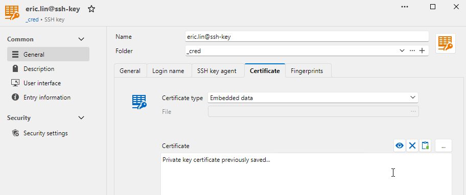

Thank you for the details. Looking at your screenshots, the same SSH key entry is linked twice in the SSH Shell entry: once in Credentials (General tab) and once in the SSH key tab. The certificate is taken only from the SSH key tab, so the link in Credentials is not needed. Could you please try the following?
1. In the SSH Shell entry, General tab, remove the link in Credentials (set it to "Username and password" and type only the user name, or leave the user name in the Login name tab of the SSH key entry).
2. Keep only the SSH key tab linked: Private key = Linked, with your SSH key entry selected.
3. In the SSH key entry, Certificate tab, click the eye button to view the certificate. Does it start with "ssh-rsa-cert-v01@openssh.com" (or the equivalent for your key type)? It must be the content of the signed "-cert.pub" file, not the plain public key. Also, on the General tab, please check that the matching private key is stored.
4. If it still fails, please configure the private key and the certificate directly in the SSH Shell entry (SSH key tab, File (local) or Embedded data for both), without linking, and tell us whether it works that way.
5. Please send us the SSH log with verbose level 2 from a failed connection: https://docs.devolutions.net/rdm/kb/how-to-articles/send-ssh-logs-verbose/
