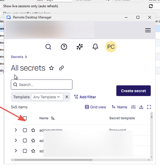

Hi,

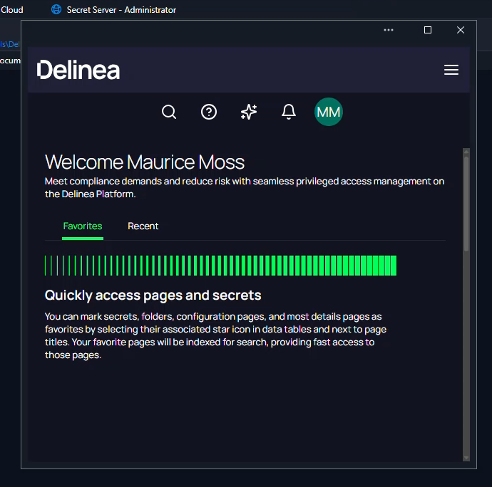

Thank you for the detailed request. Before we go further, I want to make sure I understand the problem. From what you describe, your Platform-native users get the Delinea Platform login page inside RDM. Is your main concern that you don't want that login page? Or do users sign in successfully, but RDM then fails to browse, search, or retrieve secrets?
If it's the login flow itself, that's expected. Users created directly in the Delinea Platform have to sign in through the Platform's own login page, which is where your identity provider and MFA are handled. Delinea doesn't let an application like RDM sign these users in with just a username and password, the way Secret Server allows for its own accounts.
If you really need to avoid the login page, the only other option would be Delinea Platform service users. These are accounts that Delinea provides for integrations, and they can sign in without the embedded browser. RDM doesn't currently support that option, but it's something we could look at. Each user could have their own service user, saved in their RDM My Account Settings, so nobody shares an account and the Secret Server audit log still shows who did what.
Keep in mind that a service user isn't the person's own Platform account, though. Each person would need an extra account for your admins to create and maintain. Its permissions would need to be kept in sync with the person's own. It doesn't go through MFA or your identity provider's sign-in rules. And it has to be disabled separately when someone leaves.

Hi Jonathan,
That's right; RDM does not retrieve the session authentication token from our 100% finalized Delinea platform for this “native” regular platform user.
That's right, authentication takes place via the platform's login page, but the bearer token couldn't be passed, and the RDM got stuck on the platform page and the login page itself, so no further RDM actions are working. It looks like the RDM can't handle native platform users.
We didn't want to bypass the login page; rather, we wanted to set up a functioning platform login and access to Secret Server secrets through the platform so that the platform would allow users to correctly retrieve the secrets from the platform (and the Secret Server contained within it) for normal RDM use. This is currently not working—despite the platform having been migrated to its final version and a Delinea platform user account having been 100% converted and recreated.
In conclusion, we don't want to use service users; instead, real, 100% platform users should be able to log in and retrieve secrets from the platform via RDM, just as it previously worked natively with Secret Server users in conjunction with RDM.

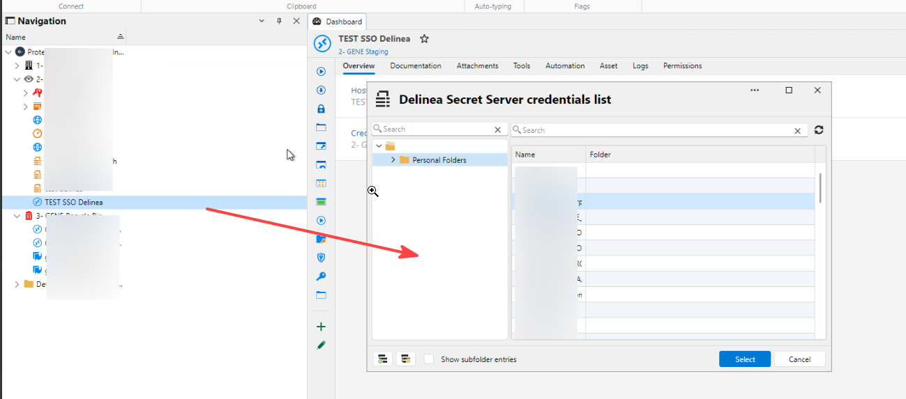

Thank you, Jonathan, for your explanations. We’d be happy to work through this together in a short session using the latest RDM version and in our Delinea test tenant. Currently, we’re seeing an issue with the transfer of credentials from 100% Platform users to RDM and authentichation with Platform users.

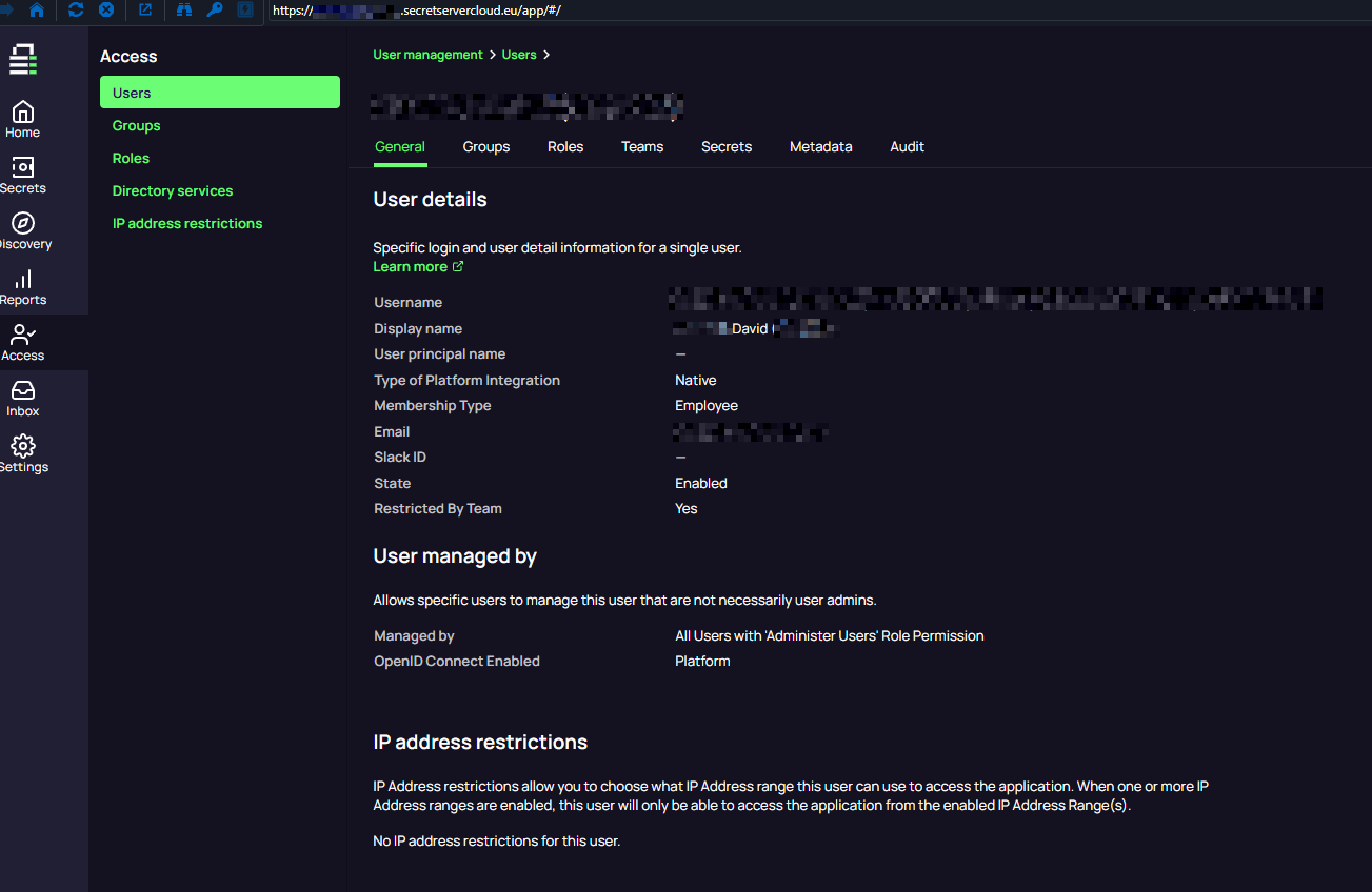

From what I have been able to see within our Delinea Platform, on a tenant where the Delinea Platform and Secret Server are integrated, we were not able to create a user that exists purely in identity platform with no Secret Server account.
Any user created directly in the Delinea Directory is automatically provisioned a linked Secret Server account - it shows up with Secret Server user type "Native" - and that linkage is created automatically with no option to skip it at creation.
That's worth flagging because of a terminology overlap: in Delinea's model, a "Native" user is one created on the Platform that still has a Secret Server account behind it — which is not the same as a user with no Secret Server identity at all.

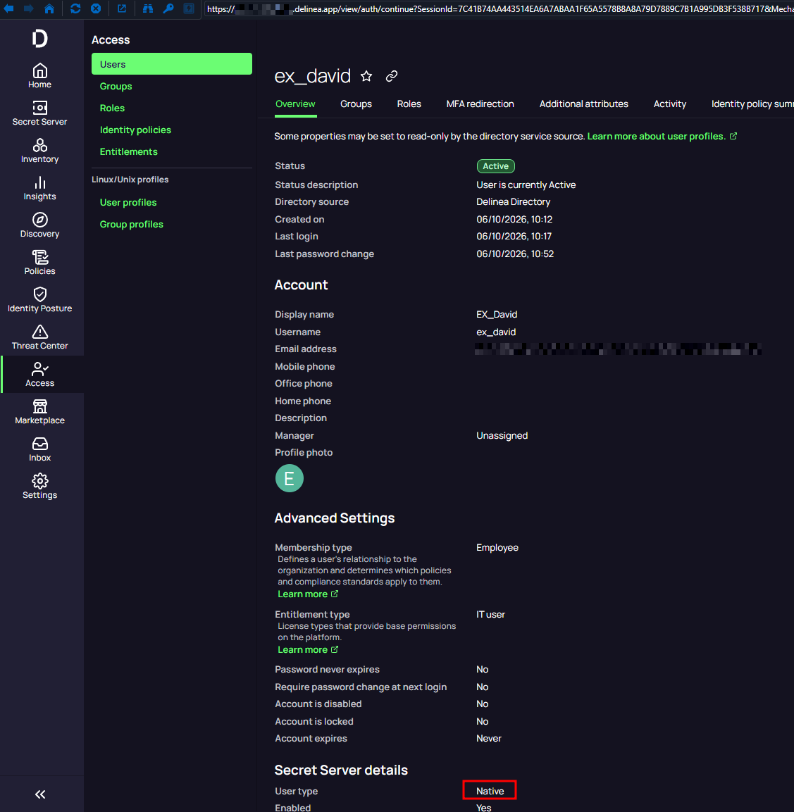

The problem occurs when using the Pure Delinea Platform (Created as the Platform with a Secret Server created at the same time automatically (out test tenant)) or a new user created after our Secret Server Cloud instance (PROD) transitions to Platform Managed and we create a user on the platform that then gets mapped to the Secret Server Cloud as you can see in the attached pictures. We are available to give you access to our system to look at exactly what's going on or collect any logs needed to diagnose it.
> For the users that fail, what directory source are they coming from — Delinea Directory (local), Entra ID, Active Directory, or a federated SAML/OIDC provider?

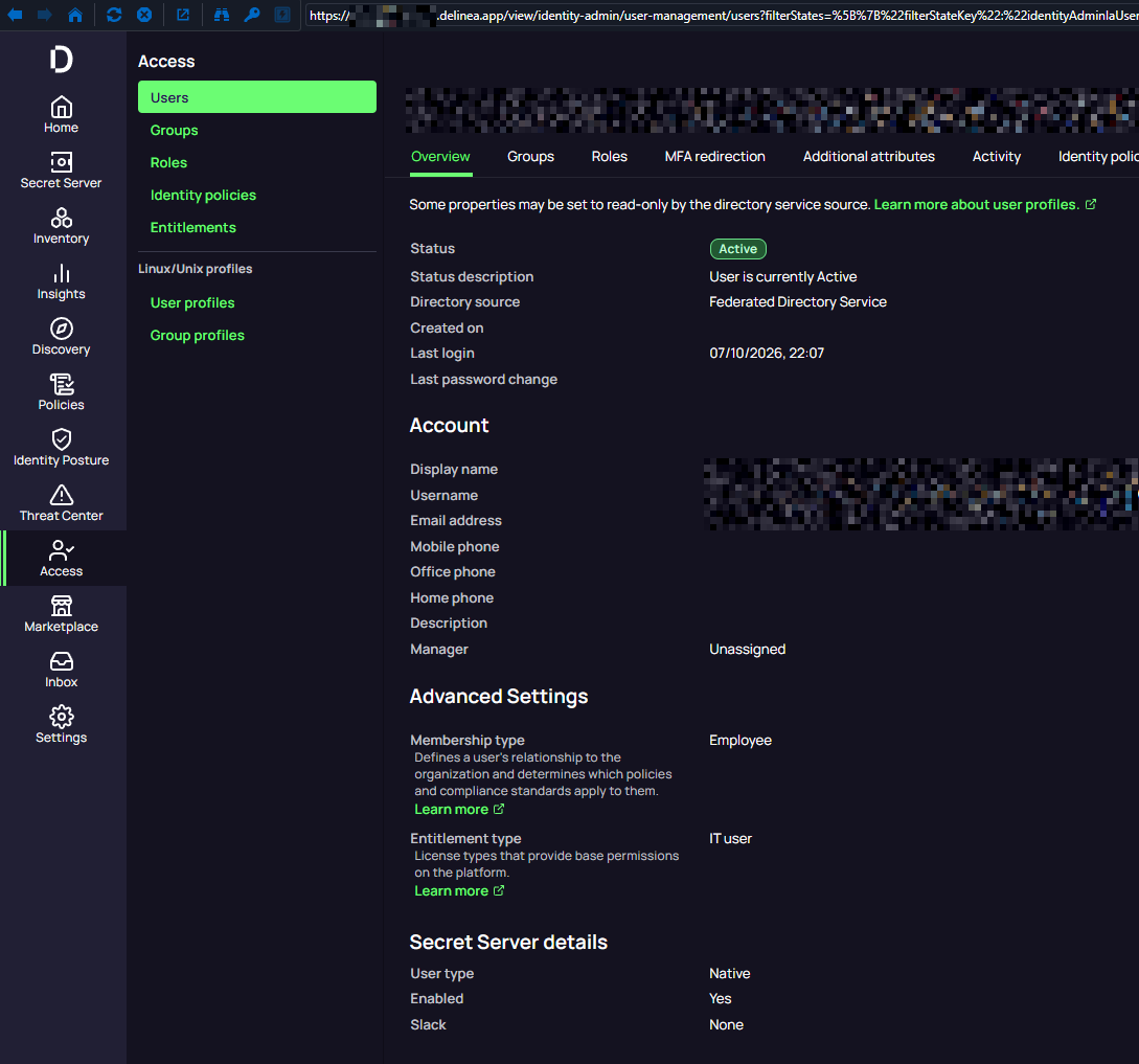

In this case we were working with a Delinea Directory User... Interestingly I forgot to test a newly provisioned Federated user frm Entra ID so I did it now and that seems to work fine. Sorry the main use case for us is Entra users and potentially different API users that should work outside RDM anyways. I will talk to the team to test this a bit more but sorry for potentially wasting your time :/

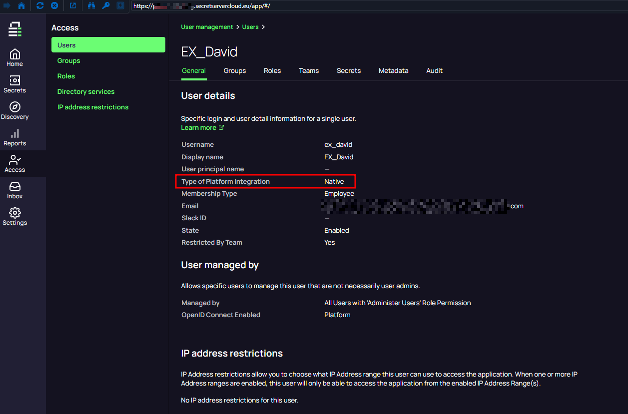

> On one of the failing accounts, what do the Secret Server details show — a linked account (user type Native or Hybrid), or none at all?
The native Delinea Directory user that doesn't work Shows Native on the Secret Server when created on the Platform.
> Have the failing users ever signed into the Delinea Platform web UI directly, or is RDM their first/only entry point? (The Secret Server account appears to be provisioned on first Platform login, so a user who's only ever come in through RDM may never have had one created.)
Login to Delinea Platform was made but not to Secret server. (Because after the Platform is adapted there should be no management or direct login to the Secret Server Clous except for API use.
