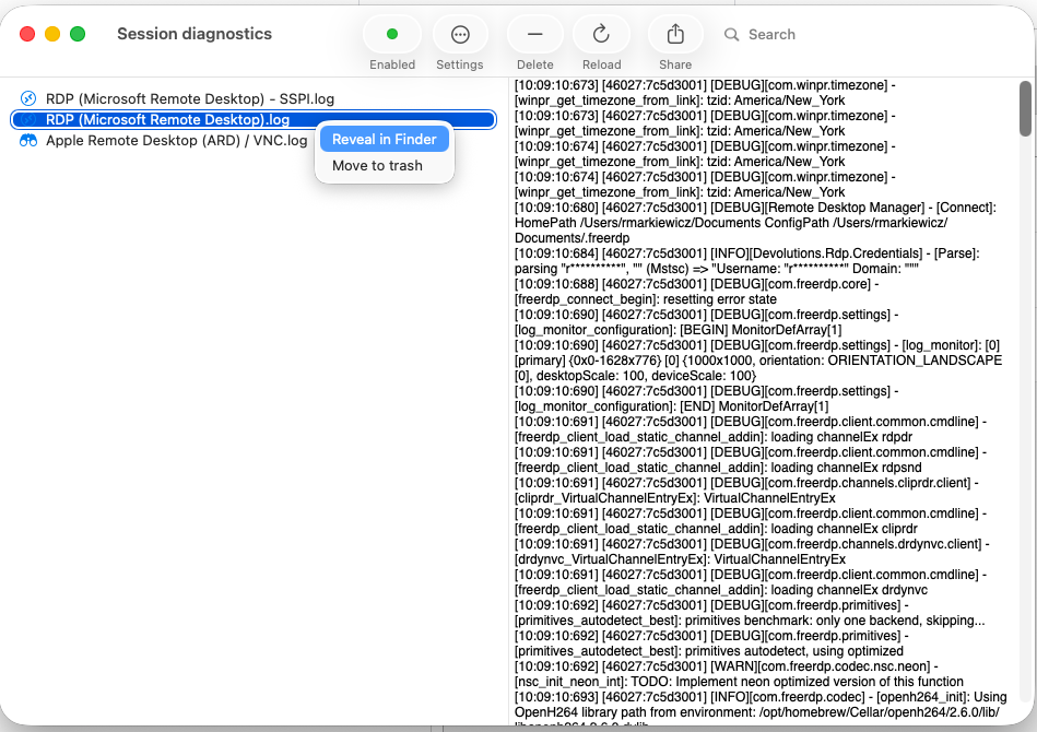

Can you try the following for me:
  • Close RDM completely and then re-open it
  • Go to Help > Session Diagnostics and in the window that opens, click the red pill to enable logging
  • Go to an RDP session and open it, and trigger a WebAuthN flow. This will fail as we've already seen.
    • It would be best to use the Yubikey if possible as that matches my environment for comparison
  • Close the RDP session
  • Go back to the Session Diagnostics window and right-click the "RDP (Microsoft Remote Desktop).log and choose "Show in Finder"
  • It will bring up the log file, please .zip it and send it to me by private message
  • Disable logging again, or close and relaunch RDM to disable it
Please, let me know if you have a question or something isn't clear
