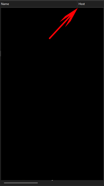

Hello,
When we have more than one column in the navigation pane, it seems we are not able to resize them right now (at least, not reliably). If I click on the "divider", the line appears for a brief second as if it will let me resize, but then it disappears, and dragging while holding my click does nothing.
If I try to click and then drag super quickly after clicking and then let go quick (so the whole resize attempt takes 1s or less), it will sometimes work - maybe 1 out of 4 or 5 tries. But any resize attempt that takes any length of time seems to just fail silently, and even the very "quick" attempts usually don't work.
This is in v2026.2.19.0 (just upgraded today).
If any additional info is needed, please let me know.

Thanks for the response. Data source is SQL Server (we do not use Devolutions Server, just RDM). I have the "disable horizontal scrollbar" option in Settings -> User Interface -> Tree view disabled already, for this exact reason (as you mentioned, when that is enabled, I am not able to resize columns as needed and display them how I want - I disabled this many versions ago). Just double-checked to make sure it was still disabled, and it was. Display scaling in Windows is set to 100%.
I had some interesting findings today though. I originally noticed this issue on v2026.1.24. Yesterday, I upgraded to v2026.2.19, and confirmed even after the upgrade that the issue remained - that was when I posted this thread.
This morning I went to check on the things you asked - I had 4 columns displayed in the nav pane: name, host, URL and specific settings. So I went to column chooser and added a new column (Creation Date) to see if it made any difference - and suddenly the resizing seemed to start working again (for the most part - still one quirk - see below).
I don't know if adding the column somehow "reset" something or what, but it seems to have helped. Ever since I added that column, I seem to be able to resize normally now. Maybe my UI was just in a bad state or something still after the upgrade.
In hindsight I think I may have reported this too soon after upgrading. Now I'm wondering if the upgrade actually did fix the issue, but maybe there was some lingering bad UI state which the column change somehow reset. Not sure if it makes a difference but I did upgrade using the in-app upgrade process (so it launched the updater, closed and updated itself, and then re-launched), as opposed to closing RDM, manually downloading the installer and running it, and then re-launching. I apologize for the false alarm, I probably should've tested more thoroughly on the new version before posting.
That being said, there is still one thing I find strange - it doesn't let me resize the first column (which is "name" in my case) smaller than a certain point. For example, even with it working better now - I can expand - but I can't shrink any further than this (drag-n-drop now shows the line moving with the mouse but when I release the click it just does nothing).
Not sure if that is by design or not? Do you know if there's a minimum width on the Name (or any) column?
Also, a side note/question I encountered as I was testing some of this - how do we remove columns from the navigation pane? I seem to recall there used to be a "remove" button if we right-clicked a column header, but I don't see it anymore? And when we go to "column chooser", we only see the columns that haven't yet been added - we can add them with double-click, but not sure how we remove existing ones now...
I very much appreciate all the help. Please let me know if any further details are needed from my side.

Hi Alexis,
Thanks for the detailed response and suggestions, it's very useful info. Just wanted to report back that on v2026.2.19, the problem does seem to recur, and adding a new column does not always seem to fix it. When it happens, it reverts back to the behavior I described where only a very quick change will be accepted - e.g. if I click and drag the column border for a half-second and let go, that might work, but if I try to drag for 1-2 seconds or longer, it does nothing (the "drag line" disappears, and nothing changes when I release the click). The main columns I have visible there are always the same ones - Name, Host, URL and Specific Settings. In this case I tried adding Creation Date again to see if that would work around the issue, but it did not.
I will try a restart of RDM shortly here once I finish some things I am working on, to see if that might help. But I just wanted to let you know it does appear to be an intermittent issue that pops back up at times.
Also I will say I am a little hesitant to do a "reset layout" as you mentioned since I do have a lot of things about the layout in general configured to my liking (non-default), and it would probably take me a little while poking around to find all the settings to change to get it just right again 🙂 But if it becomes necessary to do at some point then I can if I have to.
