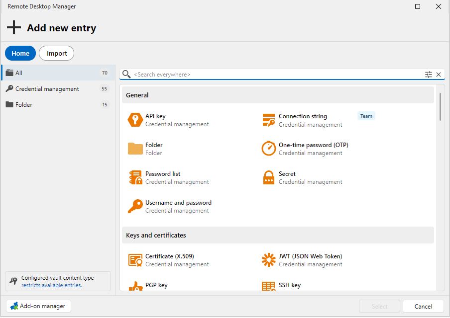

I have ran through the install and I have imported a json file with ssh shells for a couple devices this works fine, however I try to add a single SSH shell and or an RDP session. the entry type does not appear in the Add new entry, I have a choice of 70 types of Entries.

Hi,

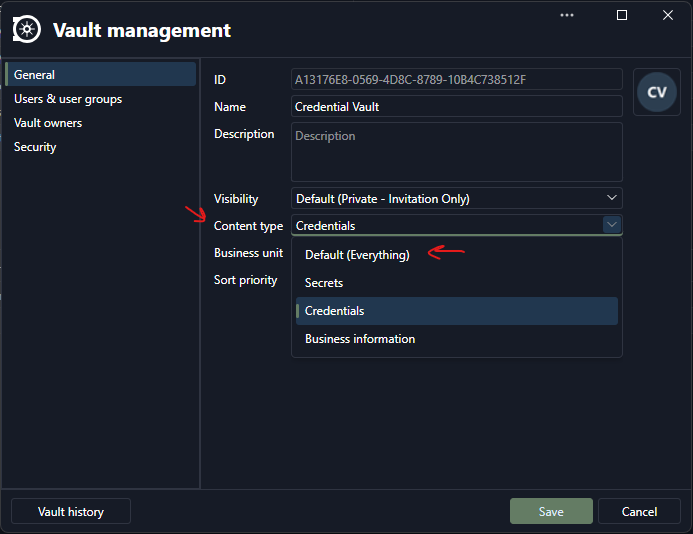

By looking at your screenshot it seems like you created a "credential vault" by mistake, if you wish to create other type of entries i would recommend changing the vault content type to everything. You should be able to edit the vault by going in the "Administration" section then in "Vaults".
Here's a visual support to help locate the option.
Regards,

OMG @Jean-Francois Duchesne that is outstanding, thank you very much that has been driving me nuts for a couple days :)
