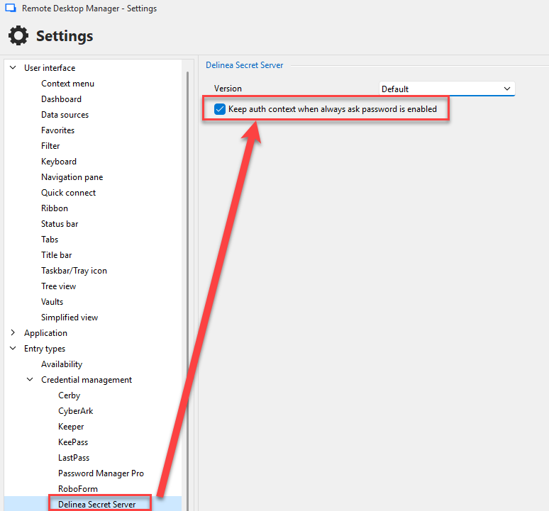

I don't get this option in my RDM current version (2026.1.14.0 64bit).
I only see this one, but doesn't change anything and, except if I misunderstand, not applying in our implementation context :
