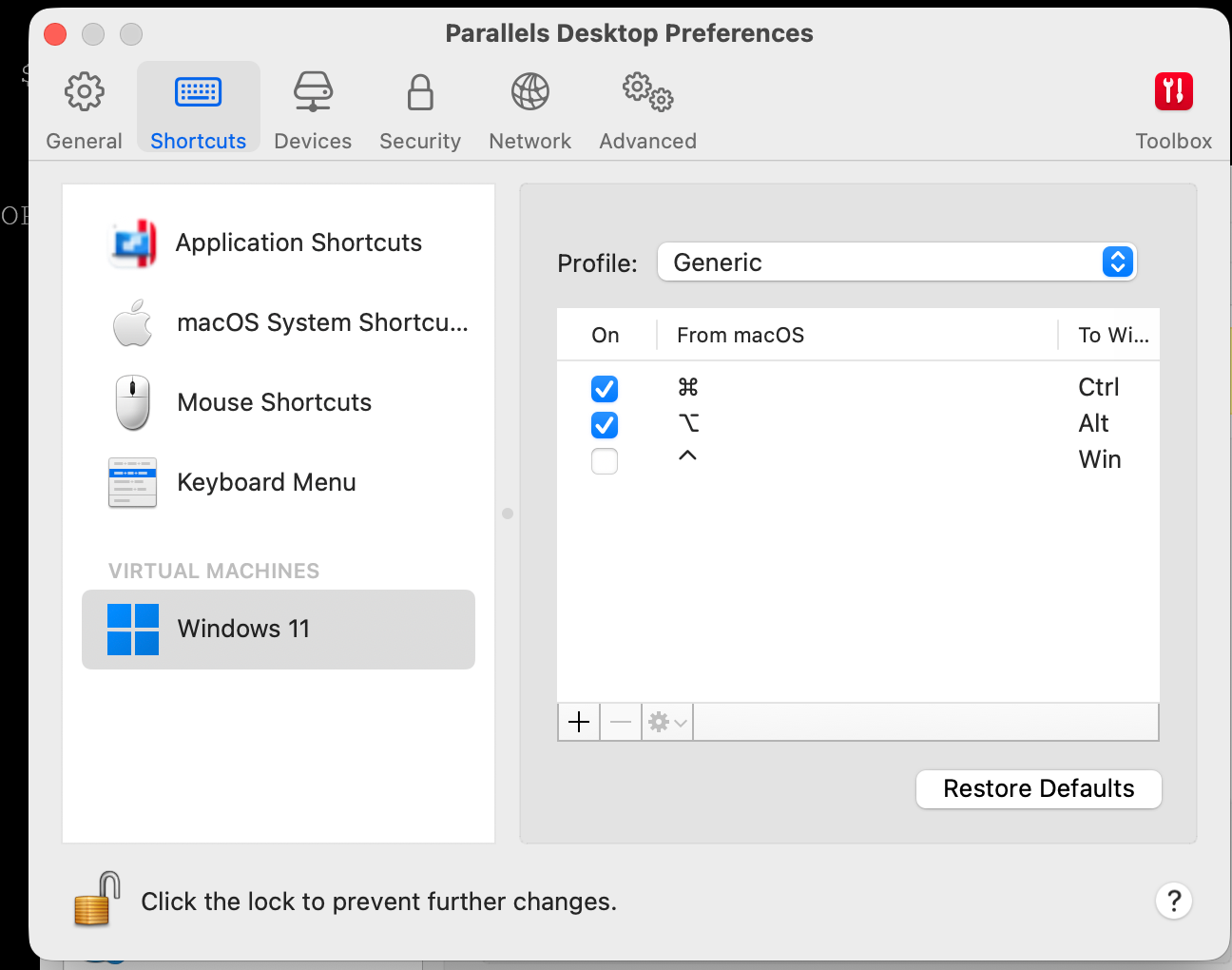

ok, which setting exactly do you mean? This does nothing:

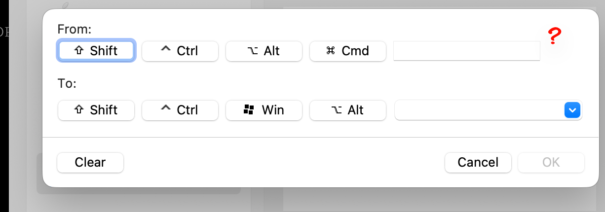

and if you mean to map NUMLOCK to "nothing" I have trouble pressing NUMLOCK to fill the "from" field here:

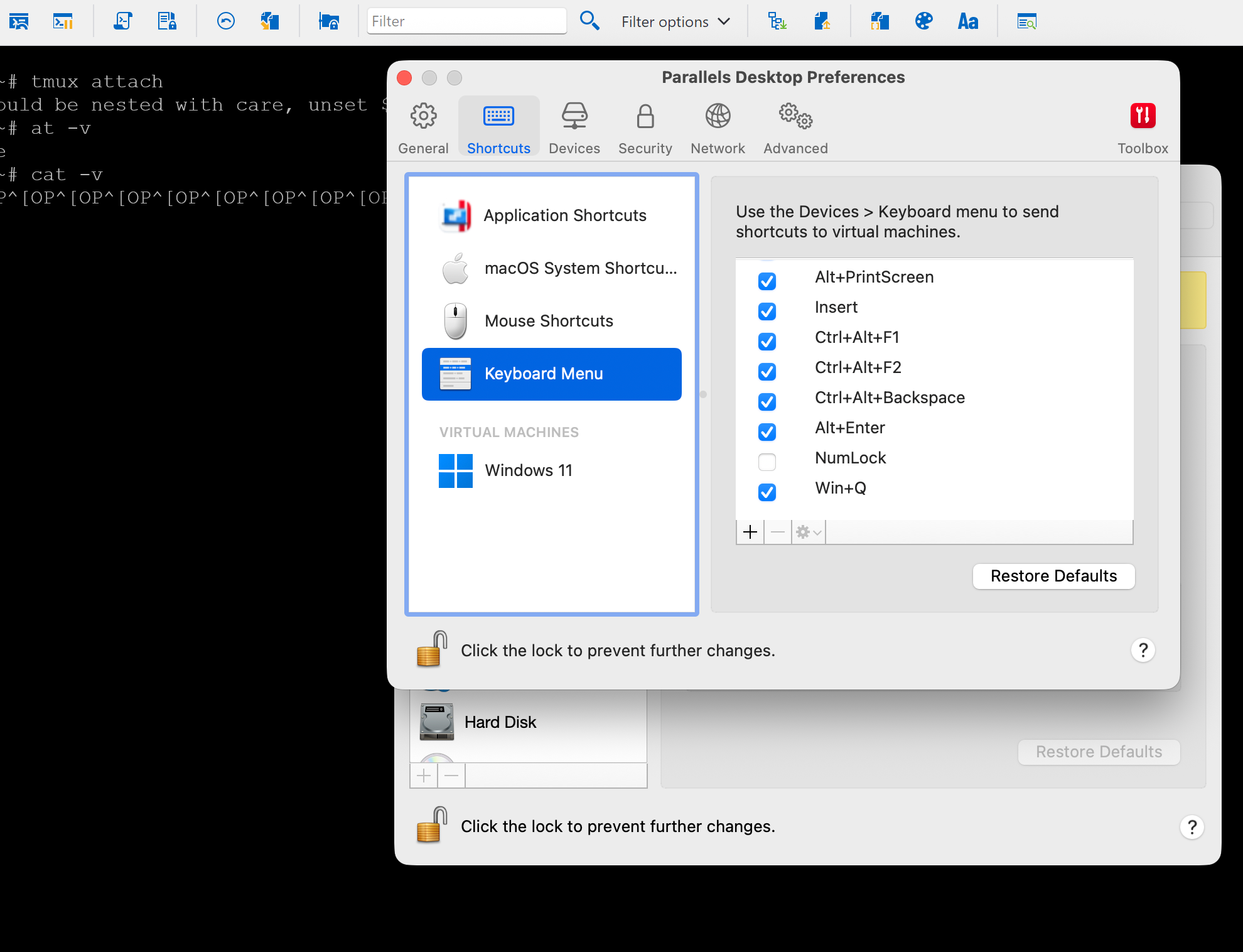

because as you can see, there is no NUMLOCK entry by default..
ok, the allmighty claude had an idea which actually worked. In its own words:
