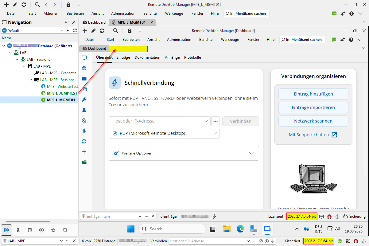

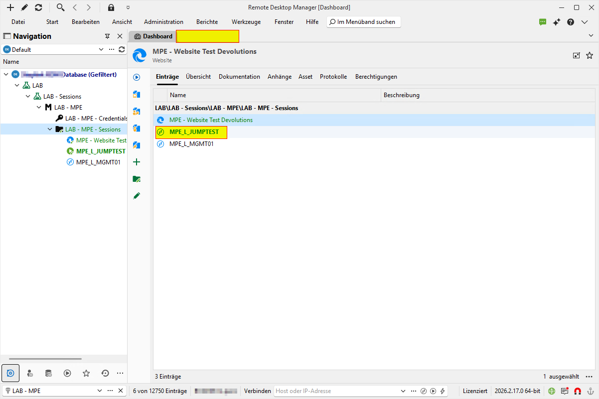

Steps to reproduce the error (Screenshots are from LAB Machines and therefore not sensible data)

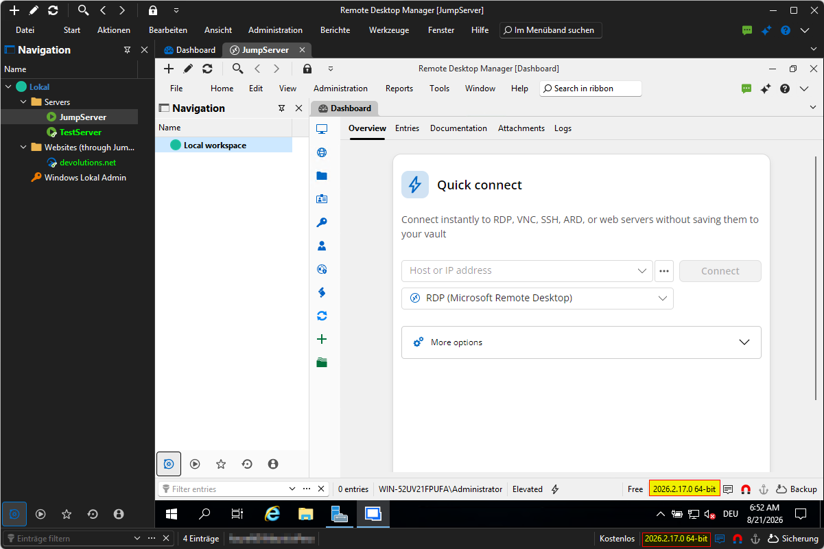

1.) Connect to the jumphost or any server through the jumphost
Sidenote:
Here the Agent Status when after connecting
And Devolutions Agent is running

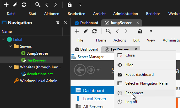

2.) Right Mouse Button on the Jumphost Tab and click Reconnect

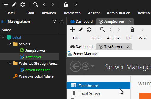

3.) Try open any other Jump or entry that goes through that jumphost. You will get the waiting window for the Devolutions Agent and afterwards the error that Devolutions Agent is not available
Devolutions Agent is still running on the Jumphost but connection to the main RDM is lost
Workaround: What fixes the problem, would be to disconnect from the jumphost and reconnect with it close. But that does bring the problem, that it always opens as a tab again and moving just this window to smaller monitor becomes (wihtout changing the entry settings) impossible. And what the reconnect doesn't fix, is the next step.
4.) Now about the locked session that I mentioned. In result of the lost agent connection, when you either close or log off the session on the Jumphost, main RDM still recognizes it as connected. Even after closing the Jump Host completely
a.) Close the session
b.) Session still showing opened
c.) Close or log off Jumphost
d.) Confirm to close all opened sessions
e.)
Jump Host closed, but previously connected session still shows as open
Workaround: You could still right-click and select reconnect on the entry to connect again, but it still keeps the session locked. Only way to release the session from this connection lock is to close RDM and open it again.
