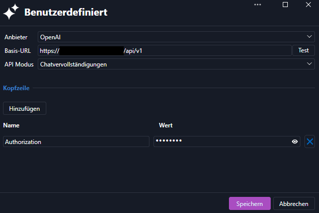

I think the existing code would support it. The only missing piece in the RDM and AI Assistant configuration seems to be the ability to pass the Authorization header, which is required for OpenWebUI’s Ollama API proxy support: https://docs.openwebui.com/reference/api-endpoints#-ollama-api-proxy-support. I don’t currently support this for any of the AI Assistant providers in RDM.
I have one or two ideas in mind. One of them is a custom provider that could have a custom name, header configuration, such as Authorization in your case, a URL or endpoint, and the provider it proxies, such as Ollama, Anthropic, OpenAI, etc. This way, I could support any product that proxies providers.

Hi @tobiasroeder,
I’ve been working on implementing the Custom Provider this week. I now have a functional AI Assistant running locally through OpenWebUI, using both GPT-5.6 from OpenAI and Ollama models.
I’m close to completing the feature for version 2026.3 (next RDM version), with plans to backport it to a 2026.2.x release. However, I’ll be on vacation next week, so it will take a little longer than expected to finalize and deliver the feature.

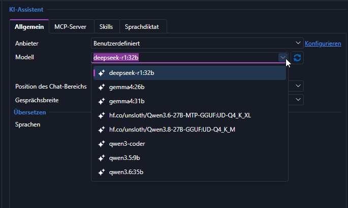

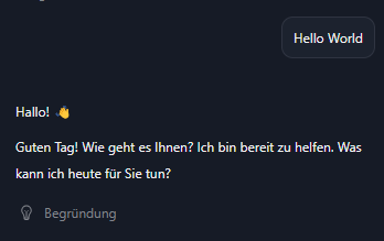

Hi @tobiasroeder,
Quick update for you, since it's been 18 days since my last reply. I've got a working solution with Open WebUI running in Docker locally, as you can see from the following screenshots. I'll do my best to get it done and tested so it can go into the next release on Monday, August 3rd.
Maxime Forest
