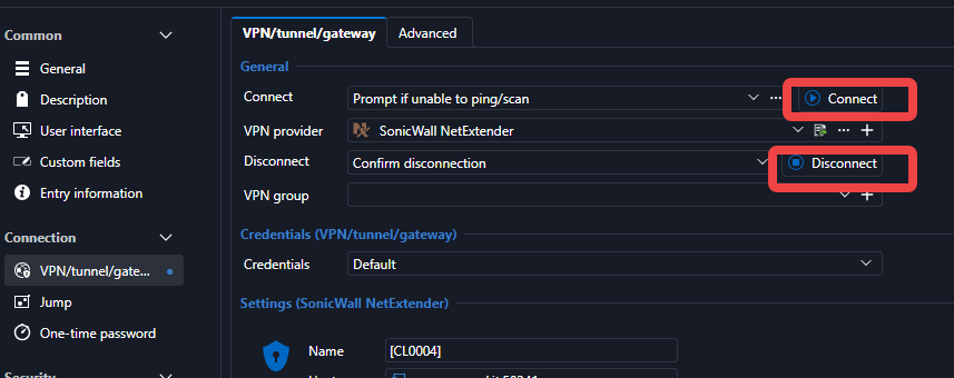

Hi there,
just installed the new SonicWall NetExtender client (10.3.0) and RDM is not able to call it anymore. I think that the issue is that in the program folder there's no necli.exe anymore, but a nxcli.exe instead.
Can you try to look at that? RDM entries are now broken (for NetExtender VPN).
Thanks.

We will add support for this new executable name. As a workaround in the meantime you can make a copy of nxcli.exe named necli.exe, I just tested it it works with the current version of RDM.
