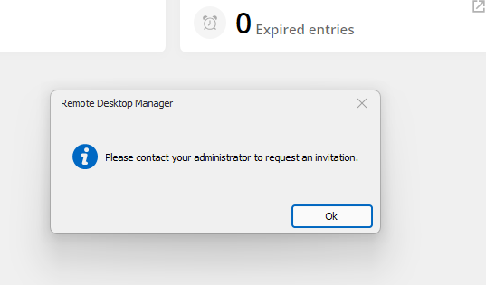

Please Contact you Administrator to resquest an invitation
Please, I need help understanding what is happening. After my network goes down, I can no longer access normal RDM. Every time I try to log in, I come across this error. I can't access the Emergency Kit, and I can't even register the My Hub Personal password. Forgive me for the English, I used Google Translate.

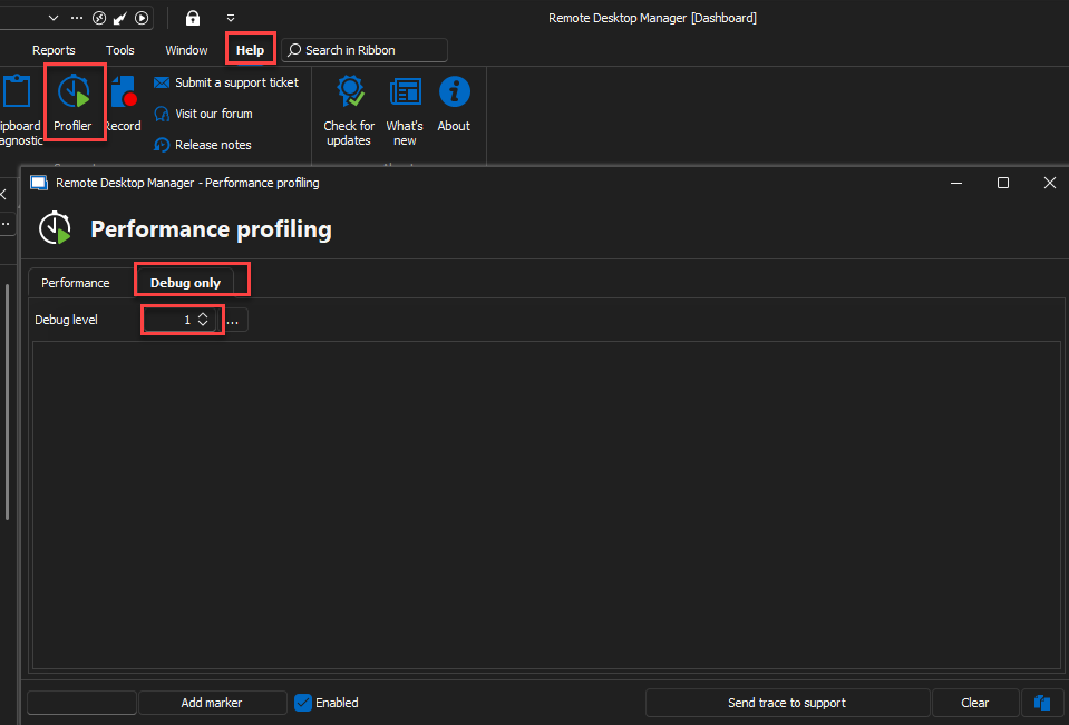

It would be helpful to us if there were some logs regarding your error. Could you please check if an error is triggered in the profiler when trying to login to your data source?
To do so, activate your "Profiler" to debug level 1 and keep it running on the side. Once it is running, try to login to your data source once again.
If your user exists, there should be an error that will appear in the profiler once the error is triggered.
Here is how to get to the profiler :
If an error is shown in the profiler after your login attempt, please copy everything to this forum thread as it should help us diagnose your issue.

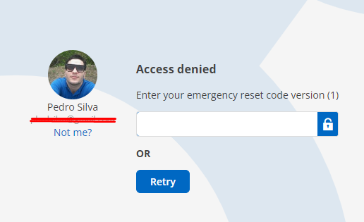

It asks for the emergency password, however, I have no idea what the password is.

Hello,
When you created or migrated your Hub Personal, you had to download a file name something similar to "Devolutions Hub Personal Emergency Kit ***.pdf" The name could be different depending on your language and the version. In that file, you have the code required to unlock your Hub Personal.
Have a good day!
