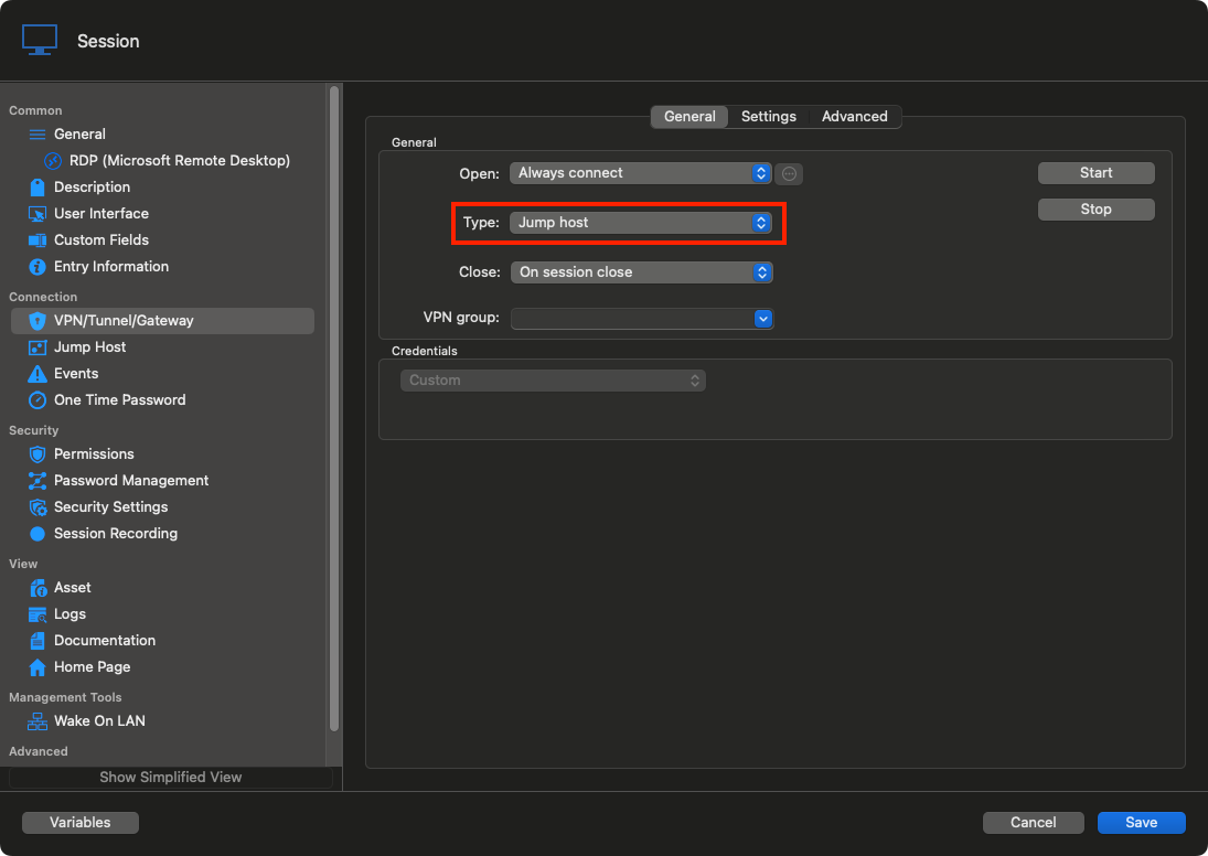

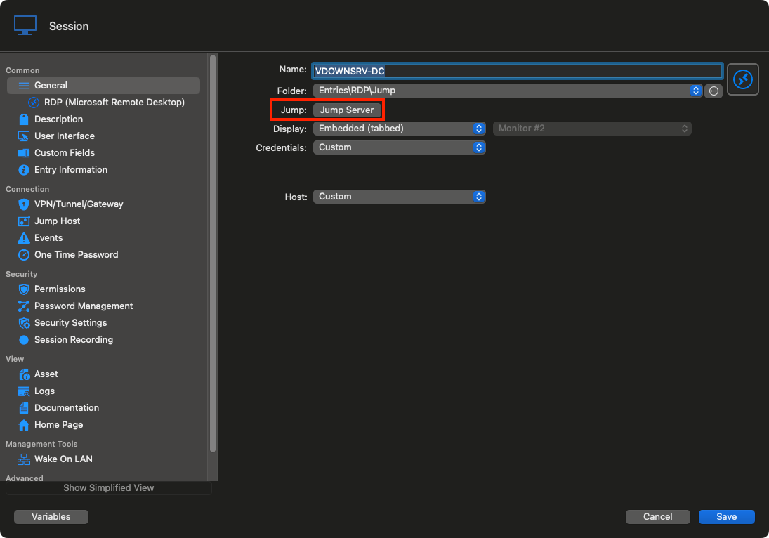

Just to confirm, are you talking about the Jump feature that can be configured here:
And here:
Both works ultimately the same, I just want to confirm we are talking about the same feature.

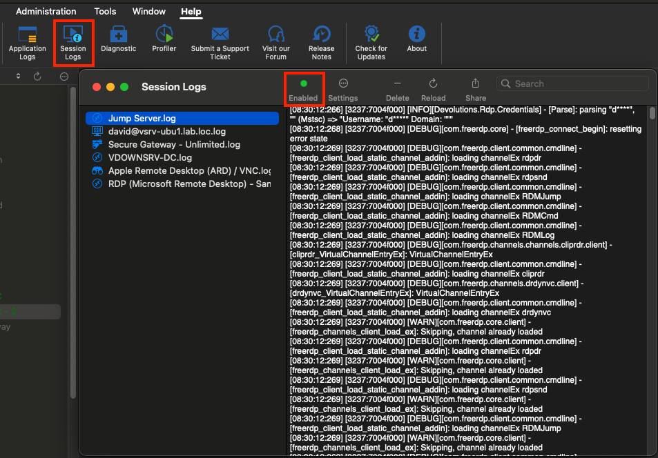

Just to confirm, I just updated to Sonoma 14.2.1 and I still have no issue launching a session configured with Jump. Another thing I'd like you to do is to enable your session logs, reproduce the issue and share with us the log that gets generated. You can enable the session logs from the Help -> Session Logs window:

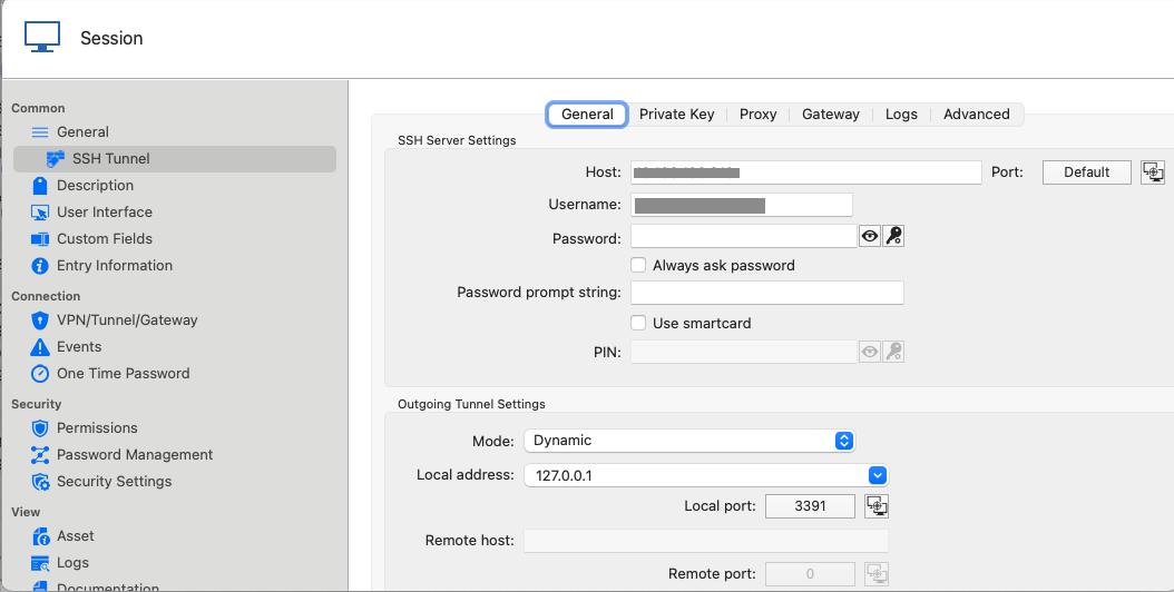

oh sorry, its not the rdm jump feature, its a SSH Tunnel.
If needed I can provide more details, logs and pic.

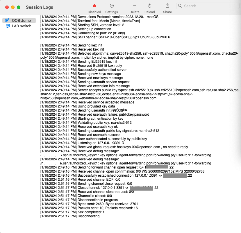

Hi,
here is the pics you requested.

Hi,
The only thing we can infer from the log is that the final host terminate the connection. From the Session Logs window, I'm guessing it possibly is LAB switch? Is it possible that there is an issue there?
Is it possible for you to try to setup this with macOS Terminal app (by launching the tunnel and session in it) and confirm if it works or not there?

Hi,
It would be helpful if you could share the log of the SSH entry (I assume LAB switch). The tunnel itself seems to work fine, and it's the entry being tunneled through it that seems to disconnect.
