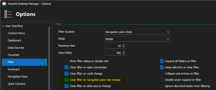

Hello,
Which RDM version do you use?
1) I assume you're referring the following setting (this will clear the filter by switching from Favorites => Shared Vault)
Regards,
Min
Yep, thanks.
What's strange is that if I have that option Checked, it only clears the filter when I change from Favorites to Vault, but not when I change from Vault to Favorites.
Anyway, I turned it off so I'm good. :)
