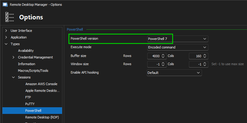

Hello Marco,
Thank you for your feedback.
The option is now under File - Options - Types - Sessions - PowerShell. We will update our documentation.

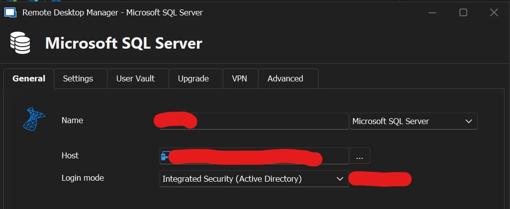

What authentication method are you using with your SQL data source?
You can use the following command to set the data source in PowerShell outside RDM. Please put your data source name between the double quotes.
Set-RDMCurrentDataSource (Get-RDMDataSource -Name "<Name of your SQL Data Source here>")
Let us know if that helps.

Thanks Érica, there is some progress....I am able to load PowerShell 7 in RDM now, however, the connection to the data source is timing out. So it seems it's related to the PowerShell version since it worked fine for PS 5.1 with the old RemoteDesktopManager module.

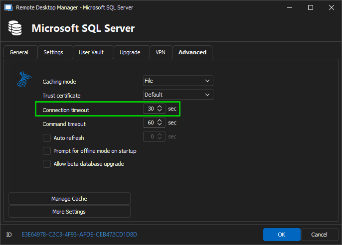

Then, it would be best if you increased the data source's Connection timeout parameter to prevent such a problem.
If you want to do it using PowerShell, you can use the following method:
$ds = Get-RDMDataSource -Name "<YourDataSourceName>"
Set-RDMDataSourceProperty -Datasource $ds -Property "Timeout" -Value 45
Set-RDMDataSource -DataSource $ds
Set-RDMCurrentDataSource -DataSource $ds

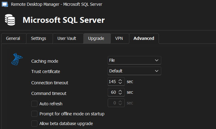

Hi Érica,
In RDM, the data source comes up fine, both via VPN or in the office. I'm using the same data source in RDM and PowerShell.
Also, the timeout was already set to 145 seconds so not sure that is the issue:
Marco.

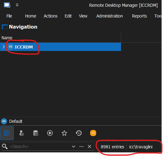

Hi Marco,
The number of entries definitely impacts the overall performance. We strongly recommend keeping the number below 4K entries per vault. The following documentation provides more information about vaults.
https://docs.devolutions.net/rdm/windows/concepts/basic-concepts/vaults/
Érica Poirier
