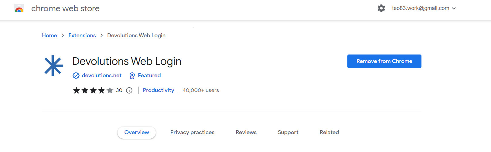

Hello, I have the latest version of RDM and I have update the extension on Chrome (114.0.5735.110) to latest version 2023.1.6.1.
If I open the program I see that the version installed is 2023.1.0.5 and ask me to update it another time....
How I can solve my issue without lost the credential?

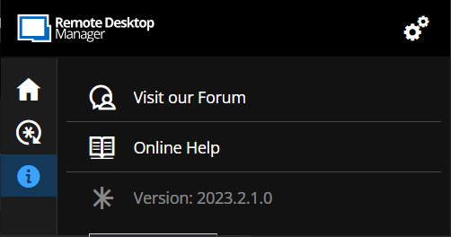

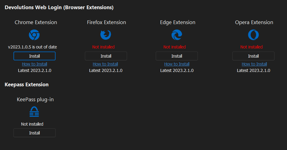

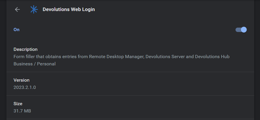

Thanks for you reply. The problem isn't that I'm afraid to lose the credential but is that when I upgrade RDM the browser extension isn't update but if I check into the browser are update...
This is what I see into RDM:
This is what I see into my Chrome:
Can you help me to solve?

Hello,
I try and this is the resul:
so in my opinion the version installed is the latest one by the RDM see an oldest one.. :-(
I try to reinstall RDM and the extension but nothing change.
Hello,
I suspect that you have more than one browser extension installed. RDM verify first in this folder:
%AppData%\Google\Chrome\User Data\Default\Extensions
%LocalAppData%\Google\Chrome\User Data\Default\Extensions
And after that in all the different profiles:
%LocalAppData%\Google\Chrome\User Data\Profiles
The extension ID: neimonjjffhehnojilepgfejkneaidmo
Could you verify?
