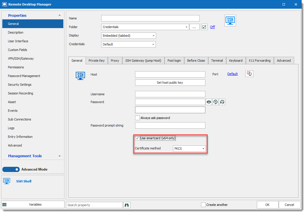

How can I configure smartcard auth in ssh shell ?
Tried check box "use smart-card (x64 only), but nothing happend.

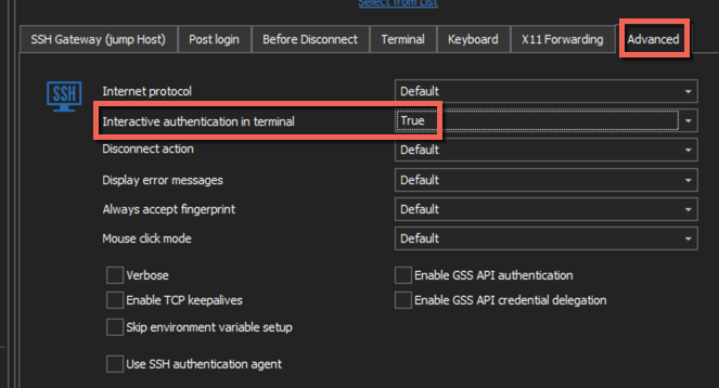

Hello,
Not sure if it's gonna help, but could you try to set the Interactive Authentication in Terminal option to True in the properties of your SSH entry.
Jeff Dagenais
ap
Disabled
Hello,
I tried to set it, but still not work.

Hi,
Are you getting this prompt even with the Certificate method to PKCS?
David Grandolfo
Yes
