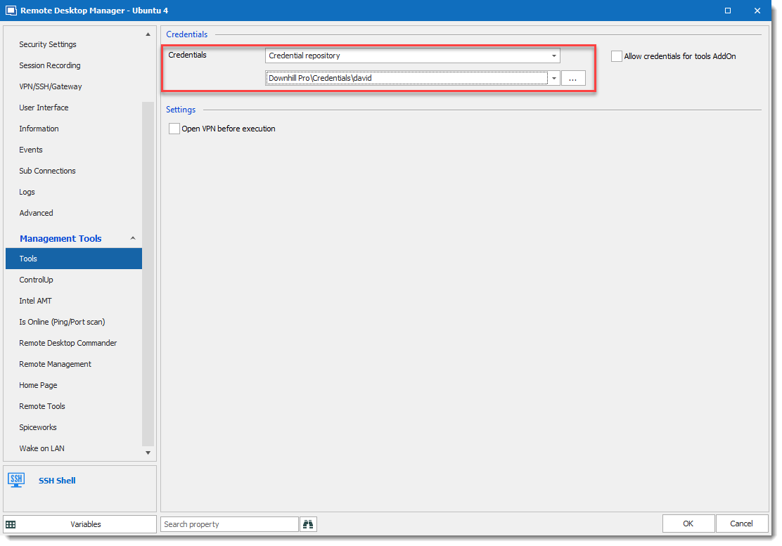

Then regarding the dynamic credentials, are you using the variable $PASSWORD$ in the after login command? If so you could use the $TOOL_PASSWORD$ which is another password that can be linked to a credentials repository or the "My personal credentials" which is unique per user.
