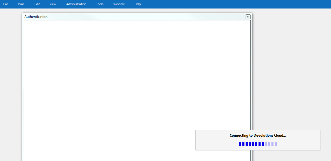

JUst run it up today (Sat 8th) after using it on FRiday and now it hangs at 'connecting to devolutions cloud. In the background is an empty window titled 'authentication'.
any clues pls?

OK, this is certainly a 'thing' and it fails when it tries to authenticate against your server(s). I've copied the old install dir (so I still have any logs) installed the prog, renamed the %appdata% dir and done a clean install.
When I first run the app up I get the 'logon/register/use Devolutions cloud' and if I opt for 'cloud', I get the never ending 'progress bar' and have to kill the app. If I 'register later' it works.

Thank you for your time today! I am happy to see that you are now able to use RDM Free.
@everyone to avoid the "Blank Page" issue, we selected "Use Serial" under Help -> Register Product.

The issue reported by @david04 was related to the registration of RDM Free using his Cloud Account. It is also the reason why the workaround mentioned above worked for him.
