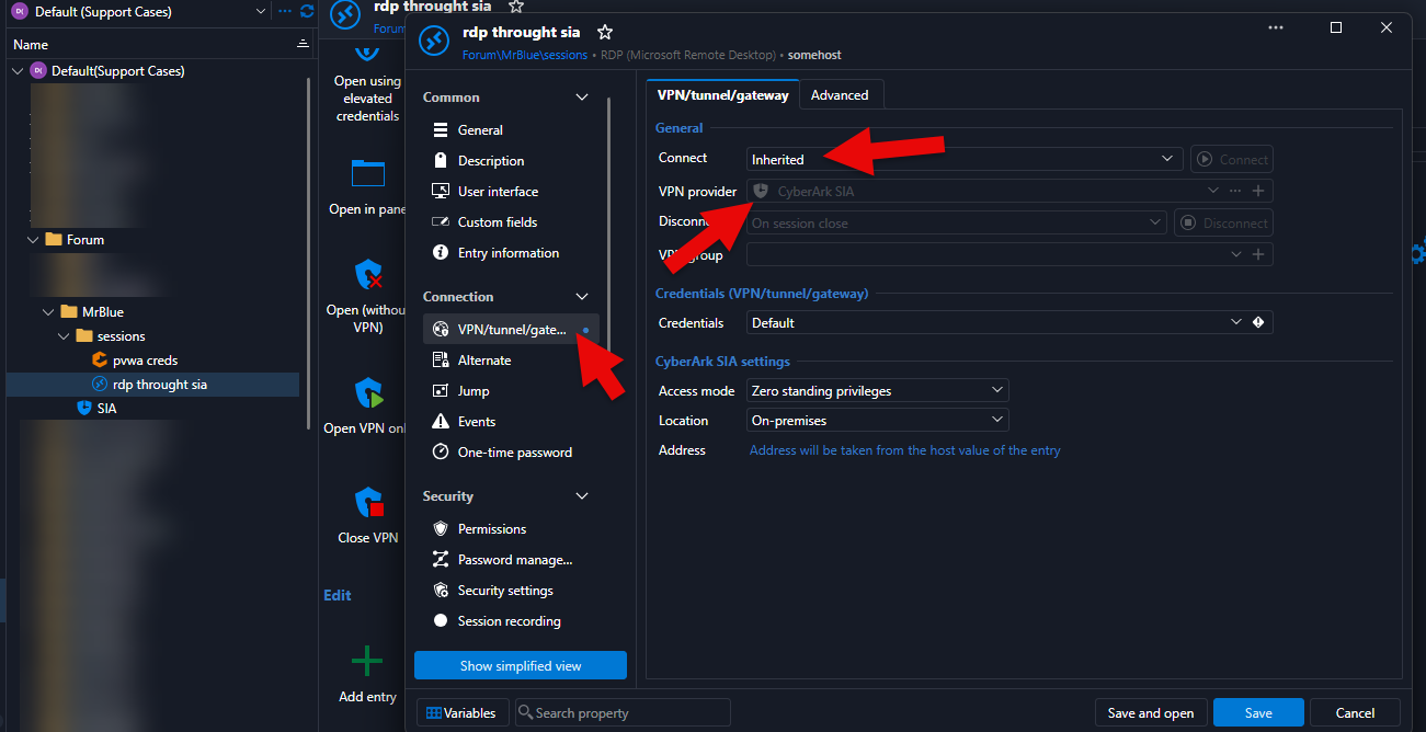

Hello,
We are currently testing the CyberArk integration in (RDM) and have observed different behavior between PSM and SIA connections.
For CyberArk PSM connections:
Issue with CyberArk SIA
For CyberArk SIA connections:
Questions
Is this the expected behavior for SIA entries?
We are currently referencing the user's PVWA credential from the User Vault using "Find by Name". Is there a reason that selecting specific account from the user vault is not possible?

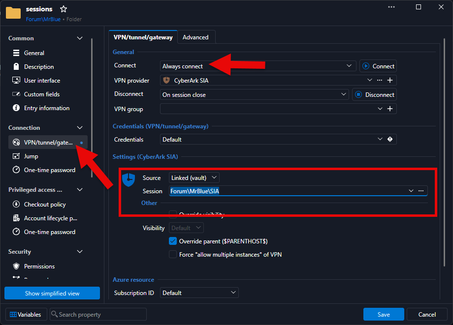

On my end, I can make SIA inheritable on the folder to the sessions. Can you send screenshots of your configuration so I can understand?
On my end:
Alex Belisle

The first screenshot shows the working configuration for one session.
However, after changing the configuration at the folder level and enabling inheritence, I am unable to connect.
We are using vaulted credentials, maybe that has something to do with this issue?

Hello,
Thanks for your feedback.
We tried on our side, and it's working as expected with the inherited SIA VPN/Tunnel/Gateway.
The approach is quite different than the using PSM, and this is maybe the part I missed in my first response.... The PVWA entry is not used at all; this is handled by SIA.
As specified at the bottom of the VPN/Tunnel/Gateway UI when selecting the SIA, the Privileged Account to be used is set in the Username field of the RDP entry, and so is the domain in the Domain field.
When launching the session, RDM will, through SIA, generate the RDP File normally obtained by CyberArk SIA and will use the documented username and domain from the RDP Entry.
Let me know if this works.
