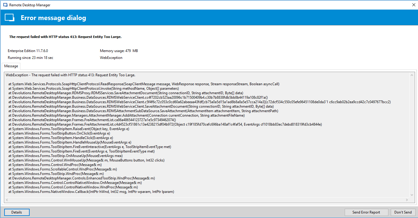

Hi Support,
I try to upload an attachment and get the following error.
What can I do to increase the max file size?
I'm using Devolutions-Server.
thanks,
Benjamin

I think I have a second Problem...
I can upload files with a size of 35KB. A 40KB file is failing. I always got the 413 Entity too large. I also tried bigger files: 10MB, 40MB, 50MB all of them failing with 413.
Please let me know if i can try something....
regards,
Benjamin

Hi,
I tried it on a Folder with the FolderType Software/Serials and a Session. I alway went to properties --> Attachment --> New Attachment.
Now, I also tried on both Folder and Session "Add Document" and "Add Attachment" but everytime i got 413 Entity too large.
My Testfile is a Licensefile (xml) with 500KB.
regards,
Benjamin

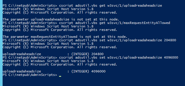

I think I finally found the issue. I was looking at our code both client and server with no luck. Looking at IIS type issues I found this stackexchange thread that I believe has the correct solution.
Following instructions from: https://blogs.msdn.microsoft.com/jiruss/2007/04/13/http-413-request-entity-too-large-cant-upload-large-files-using-iis6/
This should solve the issue (adsutil.vbs should be in C:\inetpub\AdminScripts folder). Make sure you are running elevated privileges to run the command or it will fail. I don't believe you need to restart IIS, it should be automatic.
First read the current value (post the values/response, the properties may not exist)
cscript adsutil.vbs get w3svc/1/uploadreadaheadsize
cscript adsutil.vbs get w3svc/1/maxRequestEntityAllowedUpdate the value
cscript adsutil.vbs set w3svc/1/uploadreadaheadsize 204800
Other link: https://www.iis.net/configreference/system.webserver/serverruntime
With all that I'm still not able to reproduce the 413 errors you are getting. No clue why!
Please let me know if this resolves the issue.

Great!! Thank You!!
The Values were not set. So i set the value from the Technet.
After that i could upload files biggen than 35KB but not bigger than the 200KB.
So i changed the value again to 4096000, i think 4MB is a good limit.
regards,
Benjamin
WOW it worked, amazing
We will update our documentation to help others that encounter this issue.
