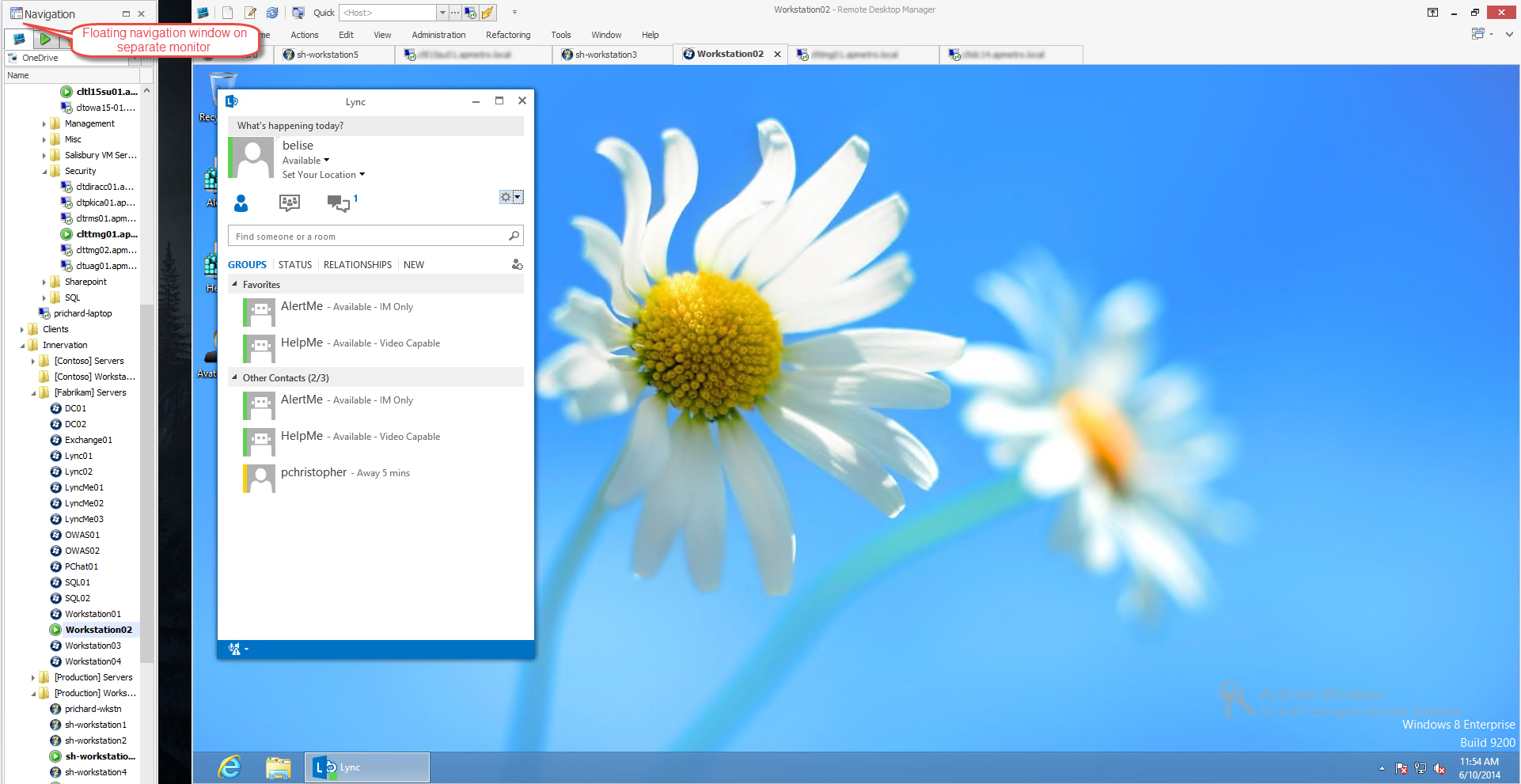

I'm not able to reproduce it. Could you send me a print screen of your main screen. You must have something different in your UI that steal the focus.
David Hervieux
If that's a little tough to read, try http://innervation.com/crap/rdm_float.png
I don't see anything special. I have asked JF to try to reproduce it on another machine.
David Hervieux
Just as a follow up, the problem ONLY happens when the nav pane is on another monitor. If I drag the floating pane to the same monitor that the "main" window is in, it works fine - docked or floating. Confirmed it still occurs in 9.4.12.0
