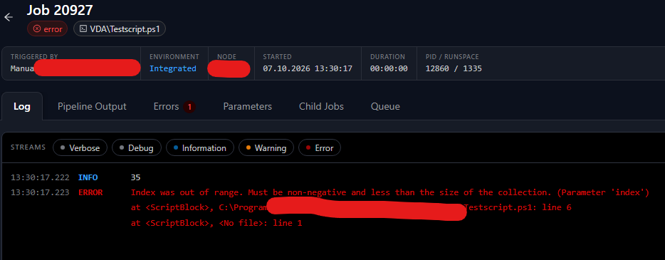

Hi, today we noticed that using Remove-PSUSchedule no longer works in version 2026.3.2. The following error message appears: (Screenshot)
It works perfectly under version 2026.2.0.

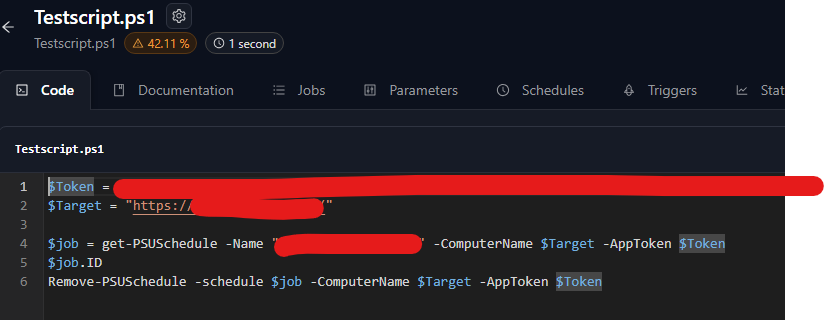

@Marco It looks like the problem is that we added SupportsShouldProcess and set the impact to High for this cmdlet in 2026.3. I don't see it in the release notes so I can see why you ran into this. You can work around it by including the -Confirm parameter.
Remove-PSUSchedule -Schedule $job `
    -ComputerName $Target `
    -AppToken $Token `
    -Confirm:$false
The exception is coming from the fact that the job host is not properly processing PromptForChoice, so we end up with an exception rather than a helpful error message. I've opened an issue to fix the host so it is more clear when something like this happens.

Thanks @Adam Driscoll, exactly what was missing. Thank you.
