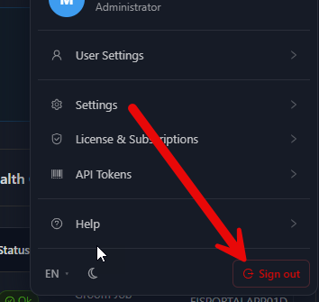

sign out on nested IIS goes to 404

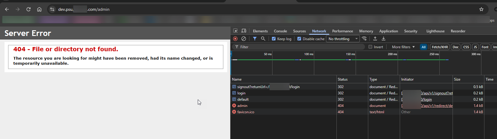

nested IIS site is missing after logout however mike has a server that does work, mine does not
26.3.1.0

Is this enough?
Hello @Matthew Morrow
Yes, this is enough. Thank you for the additional screenshot.
Since you are still seeing the 404 on 2026.3.1 despite the nested IIS logout fix included in this release, I’m going to escalate this internally for Development review.
I’ll update the thread once we have more information.
