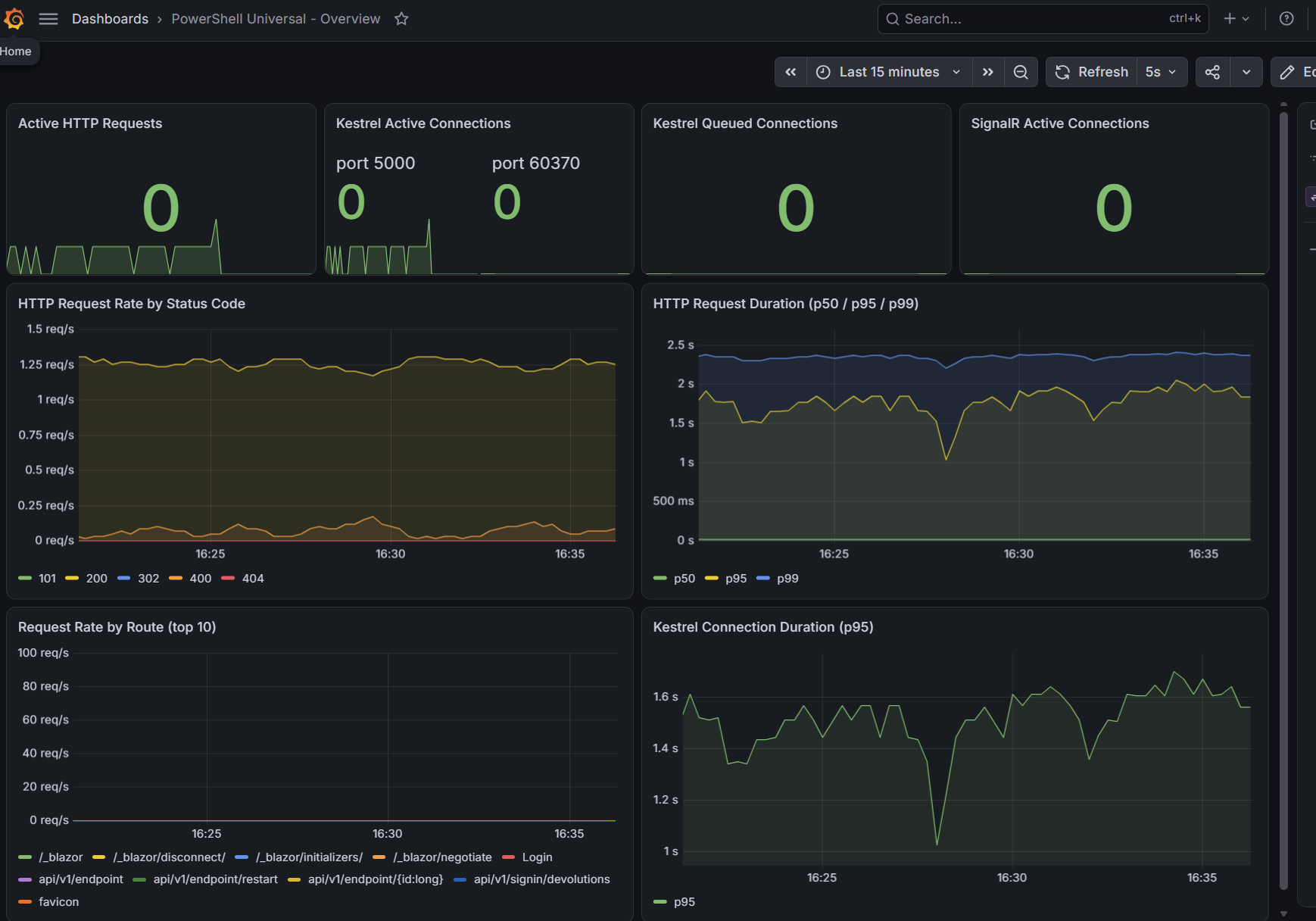

Thanks for looking into this. Here's the requested detail: (from my buddy Claude)
also can provide grafana config (for your docs/examples) that claude got working , as i suspect that is what most humans would want to get set up (if they were using the endpoints bit)
