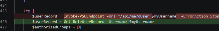

Oh adam, its totally my fault. apparently i sent it into an loop that never made it to a successful login:
DO NOT USE Invoke-PSUEndpoint in the roles.ps1 file, i reworked it to call the script directly instead of through the PSU system itself.
Good catch! I'll open an issue to safeguard against this. I haven't tried to do this before.

Ya, i was getting lazy and just trying to reusing the internal workings so i didnt have to rewrite code... :)
OKAY, after fixing the roles.ps1, i am now able to get on 2026.2.5.
