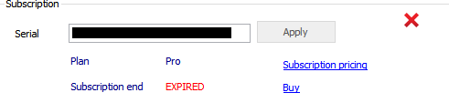

I noticed that my online backup subscription expired but I haven't receive any mail notification or pop up in RDM.
I haven't received any notification even when RDM was closed/started. I do that rarely because I restart laptop once a month when doing updates.
I only noticed red x in status bar.
Is this maybe some kind of bug or it could be improved to bring attention because backup is important?
