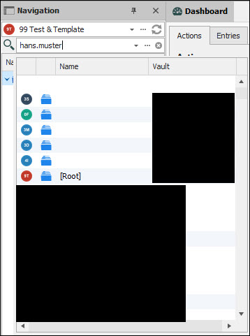

2 mths Search problem with search in all Vaults Option
Simon Keller
Simon Keller
Posts: 34
Hi
I am currently testing the latest beta version and found that the Multi-Vault search does not work.
RDM: 2019.2.8.0
If the Multi Vault Search is activated, it does not find any results but lists all entries.
Also the Multi Vault Advanced Search does not find any more results. All entries are simply displayed
Can anyone confirm that?

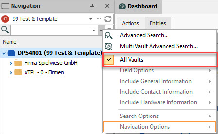

Posts: 34
Hi
After the update to the latest version of DPS (2019.1.20.0), the browser extention (8.4.1) for google chrome no longer displays all accounts with the DPS as data source.
Before the Update, the browser Plugin shows entrys of Login (Account) as well as Login (Web)
Now after the update, the Plugin shows only entries which are available as login (web)
Example
Only the green entries are found in the plugin. The red ones are not found anymore since the update.
Is this a bug, or is this what's intended?
Should this be a deliberate change, we have to convert all login (account) entries.

We have updated DPS and RDM to the latest version.
There are two problem with searching all Vaults.
1.
The search results window is docked to the search field and cannot be moved.
If the search box is at the top and is not docked at the bottom by default, not all results will be visible.
Here it would be nice if this window were not docked or if you could position it yourself. So it is not possible to have the search window in the upper area.
2.
The search field cannot be cleared using the "Clear" button. The entry remains unchanged and must be deleted manually.
Are these problems known and can you please have a look at it?

Min Destens wrote:
Hello Stefan,
this is already possible since 2019.1.18.0! Here the line from the Release Notes:
  • Added multi vault search
You can find this feature in View => Multi Vault Advanced Search
Regards,
Min
Hi

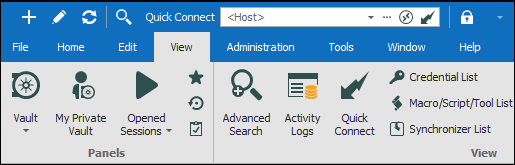

I have just updated to version 2019.1.21.0 and this option is not visible for me.
Does this have to be activated in the options?
P.S.
Can the Multi Vault search also be activated in the normal search bar (filter)?
