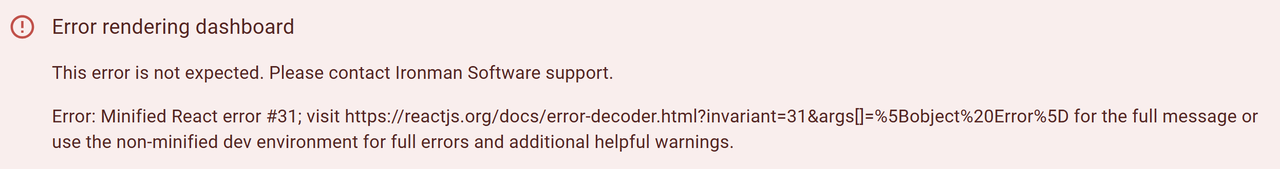

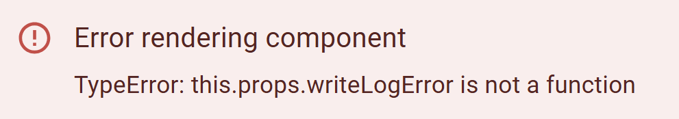

I have found if a data grid column is set to type 'date' or 'dateTime', an error appears when rendering the app. I do not see any additional logs throwing in the app's logging page or PSU's logging page.
2026.1.5:
2026.3.3:

What you found is a product defect, and it affects both 2026.1.5 and 2026.3.3.
The data grid sends each cell value to the browser as text, dates included.
When a column is set to date or dateTime, the grid in the browser only accepts real date objects, so it throws an error on the first row.
PowerShell Universal does not turn the text into a date before it hands it to the grid.
That is why removing -Type makes the page load again.
The messages on screen come from a second problem.
The error handler that should show and log the real error fails itself, so the original message is hidden and nothing reaches the app log.
I am reporting both issues to the PowerShell Universal development team.
