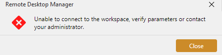

Hello,
I noticed that when i need to re authenticate i got this message on one of my RDM. i click close, and try to go online again and the authentification process start.

Hello mog54,
Thank you for the screenshot. It tells us more than the description could, and it narrows things usefully.
That message is Remote Desktop Manager's own, and it is not the sign-in failing. RDM shows it only when the workspace was already offline and it is trying to go back online: that attempt is refused before any sign-in happens, which is why closing it and going online again works. So what the screenshot tells us is that the workspace had dropped offline some time earlier. That drop is the thing to chase. Being asked to sign in again is what follows it, not what causes it.
Two values would tell us where to look, and I would like to see them before anything is changed.
  1. In RDM, open the properties of your Devolutions Server workspace, go to the Advanced tab, and tell me what Ping online method is set to.
https://docs.devolutions.net/rdm/getting-started/workspaces/workspace-types/native-workspaces/devolutions-server/#advanced
2.In the DVLS web interface, open Administration > Server settings > Security, and tell me whether Force token public IP validation is ticked.
The first decides whether RDM tests the workspace before going online, and that test is strict: it allows two seconds and accepts only a plain OK response. The second is a server setting that refuses a session which is otherwise still valid, when your public IP address changes. Please do not change either one yet. The first is also what RDM uses to decide whether to stay online through a brief error, so switching it off is not automatically an improvement.
There is one change worth making now, and it is easy to undo. On that same Advanced tab, Connection timeout is 15 seconds by default. Set it to 60. That is how long the client waits for the server to answer before it gives up, and a call that gives up is one of the things that can put the workspace offline in the first place. It will not change the check above, which has its own fixed two seconds.
