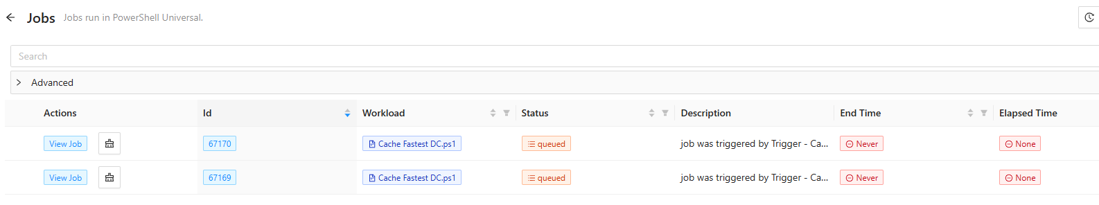

nothing will run in production i am on 2026.2.5.0, there is nothing that i can do to get into the /hangfile site also, it is access denied.

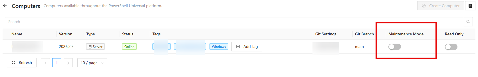

Recommended Answer
make sure this is 'off'

restarting the app pool has not helped get the jobs back into a happy state

  • all jobs are down

The logs contain a repeated JobDispatcher warning indicating that no execution computers are currently available. This is relevant to the behavior you are seeing, where jobs are created successfully but remain in the Queued state. At this point, I do not want to speculate on the root cause, but we now have a concrete technical direction to investigate.

need an improvement to tell us if we are in maint mode
