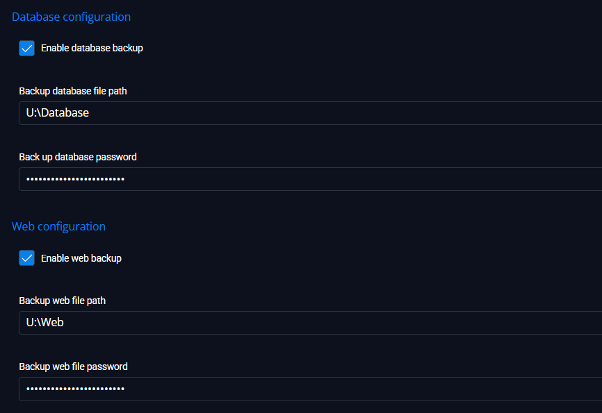

The following backup paths are configured in the Backup Manager:
The U: drive is a local drive on the Devolutions Server (DVLS) server and at the same time is mapped as a network drive on the Microsoft SQL Server.

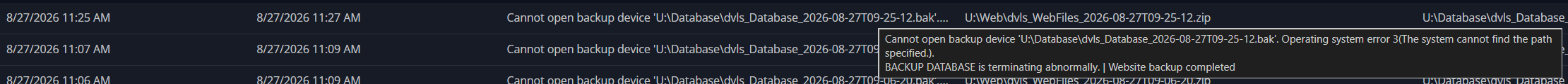

I have also tested the Backup Manager using a UNC path instead of the mapped drive, as well as a local drive directly on the Microsoft SQL Server itself. The result is the same in all cases and the backup fails with the same error message.
The following error message is displayed:

The behavior you are seeing is expected in your current setup, and it comes from how the DVLS Backup Manager coordinates the backup between the two hosts.
The Backup Manager runs the backup command on the SQL Server, which means the SQL Server service account is the one writing the .bak file, while the DVLS Scheduler (or Runner for a manual "Back Up Now") is the one that reads that file back to zip, encrypt and clean it up. For this to work, the destination path must be reachable and writable from both hosts by the accounts running those services, using exactly the same path string.
Two things in your current configuration make that impossible:
First, the U: drive. Mapped drive letters only exist inside the interactive session that created them, so the SQL Server service and the DVLS Scheduler service never see U:. That alone is enough to produce the "Can't open file" error.
Second, the SQL Server service account is Network Service, and there is no Active Directory. On the network, Network Service presents itself as the SQL host's computer account, which has no identity your DVLS host or a file share can authenticate. So any UNC path you provide will also fail for the SQL side.
