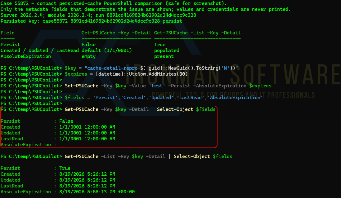

However, if I try and pull the cache detail, I get no metadata back. i.e.:
AbsoluteExpiration              :
AbsoluteExpirationRelativeToNow :
SlidingExpiration               :
Persist                         : False
Roles                           :
SecurityContextId               : 00000000-0000-0000-0000-000000000000
LastRead                        : 1/1/0001 12:00:00 AM
Created                         : 1/1/0001 12:00:00 AM
Updated                         : 1/1/0001 12:00:00 AM
However, I DO get the cached data in the Value property.

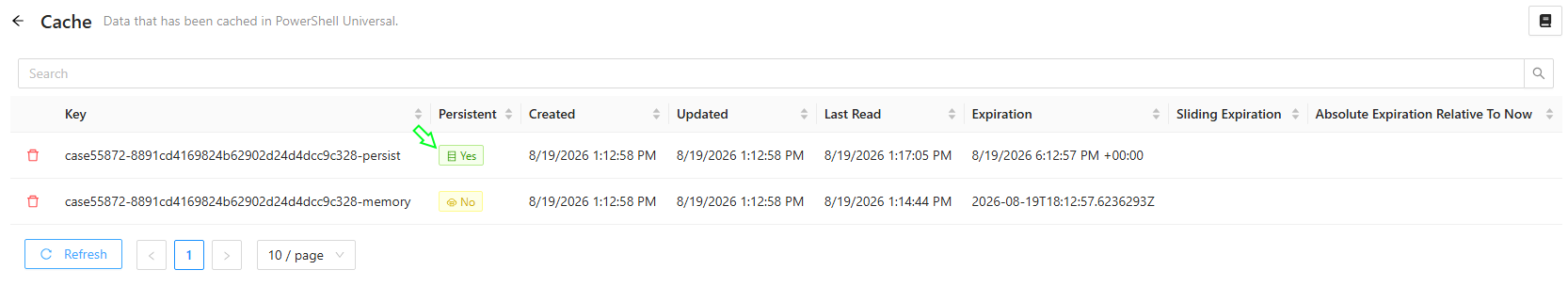

But if I view the cache in the web ui, the information's there:

I can see the discrepancy you are describing in PowerShell Universal 2026.2.4. The cached `Value` is returned, but `Get-PSUCache -Detail` shows default or empty metadata values such as `Persist : False`, `Id : 0`, and the `1/1/0001` timestamps, while the Admin Console displays metadata for the same cache entry.

  • The command I run is this (integrated flag due to ssl errors if I run it without from the app):
Get-PSUCache -Key "CacheName" -Integrated -Detail

We will build the test around the environment and conditions you shared, including Windows Service hosting, SQL Server persistence, direct node access, and the different execution contexts you tested. We will specifically compare the metadata returned by `Get-PSUCache -Detail` with what is displayed in the Admin Console and will also review the `SecurityContextId` difference you identified.
