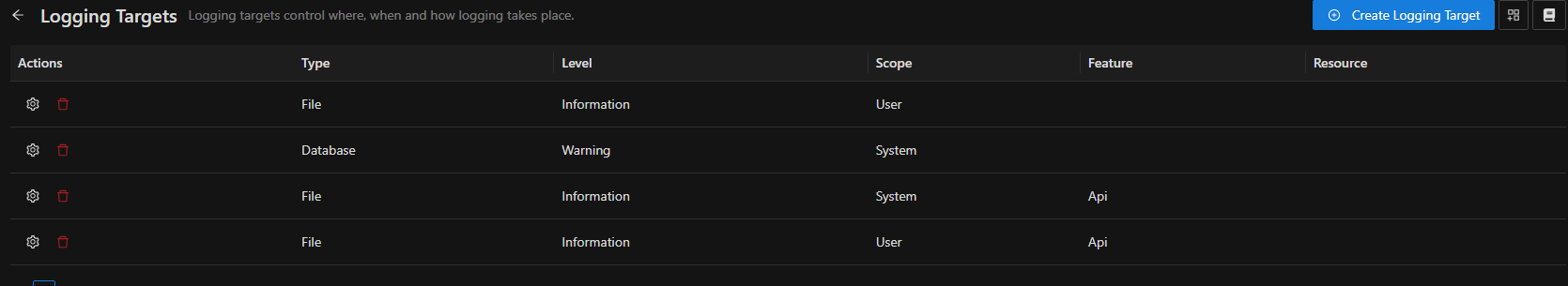

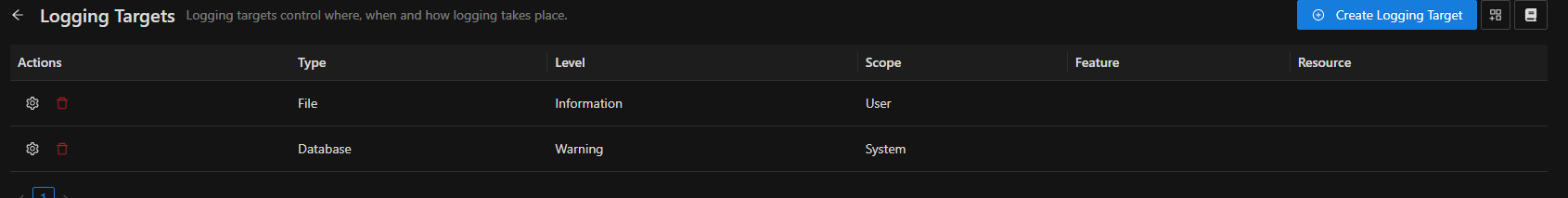

We found one additional configuration detail that may be relevant, and I would like to verify it in your environment before drawing any conclusions.
If you are using a **Database Logging Target** for API logging, could you please check the exact value configured in the **Feature** field?
Specifically, please let us know whether it is set to:
`API`
or:
`Api`
Please do not change the setting yet. We would first like to confirm the current value in your environment and correlate it with the behavior you are seeing.
Ruben Tapia

Hello nikopieper,
Thank you for following up and for sending the requested information.
We now have an update from our Development team. The issue has been confirmed as a bug related to the Feature value used by the Database Logging Target.
If the Feature is configured as:
`API`
please change it to:
`Api`
and test the Endpoint Log again.
This casing change is the confirmed workaround. The underlying issue has been identified and is planned to be corrected in PowerShell Universal 2026.3.0.
Please let me know if changing the value to `Api` restores the logs in your environment.
Ruben Tapia
