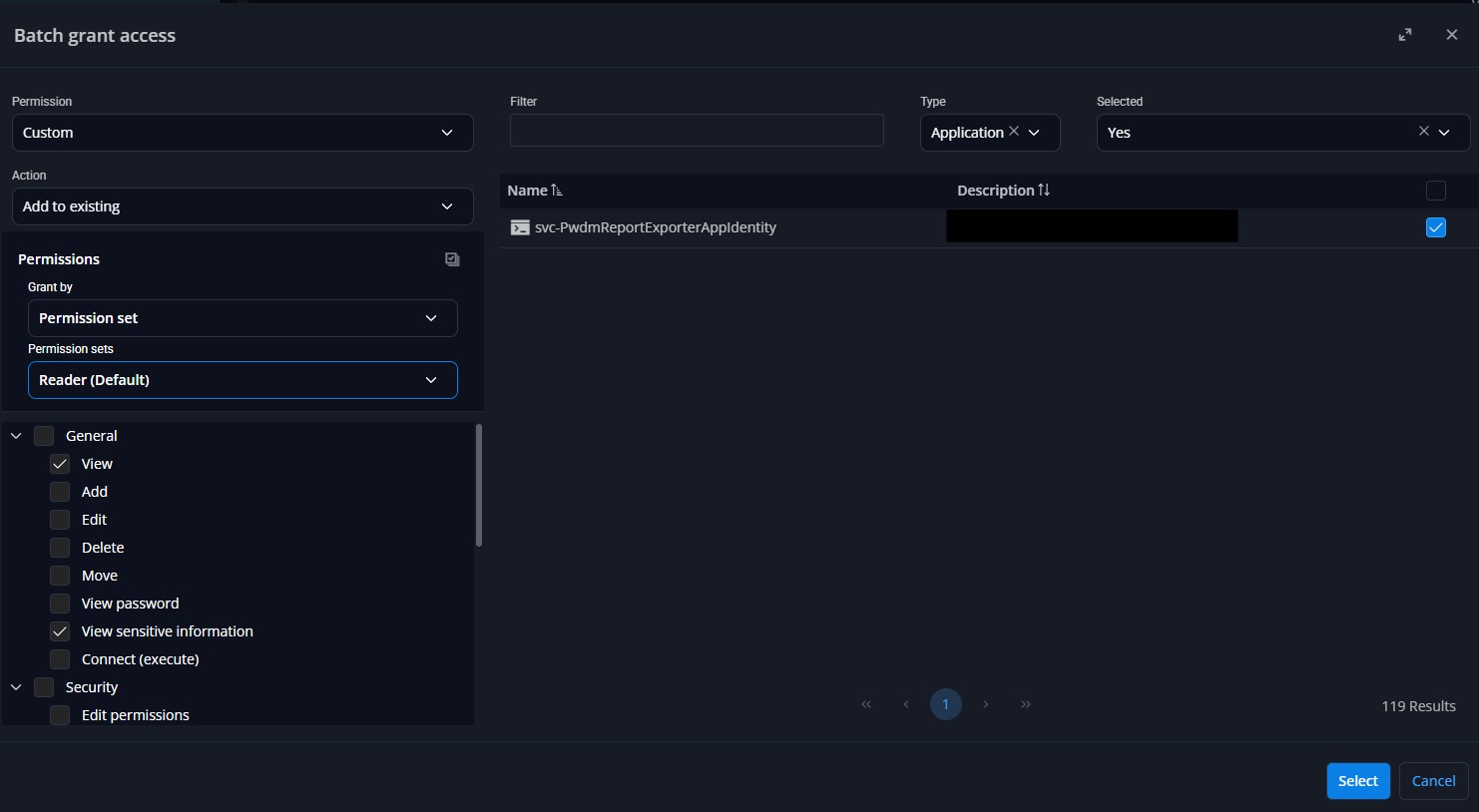

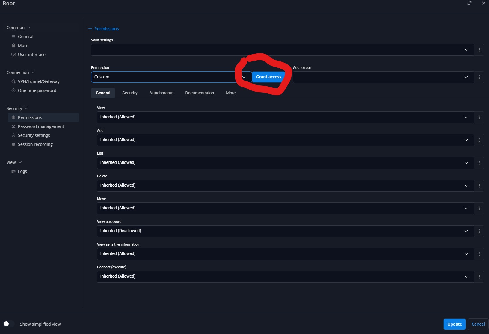

Hello again, an update:
Appears that the app connects properly, authenticates now using the app ID and its secret. Next step is failing though. It is about not able to get data from PWDM.
$AllEntries = (Get-DSEntry -VaultID $ServiceAccountRegistryVauldId -All).Data
This doesn't collect anything. I thoroughly checked the Vault's permissions and added the application as reader, as contributor, also with custom permissions, no change. The App just cannot retrieve anything from the Vault. I wonder what the proper permissions should look like?
Please advice! Thanks!
Hey ,
Good, the login is behind you. For this next step the likeliest cause is the script rather than the permissions, and it is worth ruling out first because it produces exactly what you are seeing, with no error at all - which is why nothing you changed on the vault made any difference.
Since module version 2024.2 many of the DS cmdlets no longer return a ServerResponse wrapper. Get-DSEntry writes the entries themselves onto the pipeline, so the ".Data" on the end of your line resolves to nothing even when the call worked. It does not leave you with an empty variable, though:
$AllEntries comes back with one blank element per entry it retrieved, so if the count is non-zero and every value in it is empty, that confirms it. Drop it:
$AllEntries = Get-DSEntry -VaultID $ServiceAccountRegistryVauldId -All
If you would rather leave the rest of the script alone, add -AsLegacyResponse to that call instead and the old .Data shape comes back.
If it still comes back with nothing, then it is worth looking at permissions - and a refusal here is not silent. A vault the identity may not read makes the call report an error rather than return nothing, and in a runbook that error goes to the job's Errors stream, not your output. Print $Error[0] immediately after the call and you will have it either way.
On a recent module the wording is "Failed to retrieve the contents of vault '<id>'. Verify that the vault ID is valid and that you have permission to access it." On an older one you get an unexpected-exception error from Get-DSFolders that says nothing about permissions at all - read that one as the same thing.
As for which permission it is: listing a vault's entries is gated on the identity's own access to that vault's content, which you grant on the application identity itself. That is a separate layer from the per-entry permissions you were adjusting on the vault.
It takes one of two forms depending on your instance. If the identity's dialog has a Vaults tab, ticking the vault there is the grant, and you said you gave the identity access to all vaults - so that part is already done, which puts this back on the .Data above. If it shows Role assignments instead, add an assignment scoped to that vault; the built-in Vault User role carries that one permission and nothing else, which makes it the right starting point for a read-only report.
Two version numbers would still help: your Devolutions Server version, and the module version from Get-Module -ListAvailable Devolutions.PowerShell. The module version is what decides which of those two error texts you get.
