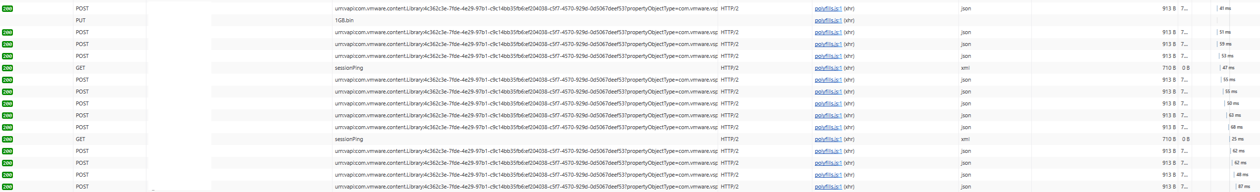

We only use a content library in vcenter so I can't use the ovf tool. I tested it with firefox where I configured the proxy to use Devolutions Gateway Tunnel. When I do an upload test (not an ova, just a .bin testfile it's as slow as in Devolutions self. When I disable the proxy in Firefox and upload the same file directly to vCenter it's fast. The speed difference is huge (a file of 100 mb takes minutes throught the gateway and seconds without).
The jetsocat logfile gives no relevant debug information. During the upload I only see logs about telemetry sites that can't be reached (that's normal, these sites are not reachable from the gateway server:

Ok, I understand and the detail that this is not confined to OVF is an important one. I still have some theories on this.
If you don't mind, can you please repeat your test while looking at the "Network" page in Firefox dev tools. We're interested in the protocol, you may need to right-click the column headers to add the column. I want to know if the HTTP PUTs are showing HTTP/2 or something else.
You can then try going to about:config and setting `network.http.http2.enabled = false`; restart Firefox and try again.

And setting this network.http.http2.enabled = false isn't doing anything it seems.
Hello
Thanks. "Isn't doing anything" is a bit ambiguous here; if you recheck the protocol column does it still show HTTP/2? i.e. the setting genuinely had no effect and the test didn't tell us something. Or it shows HTTP/1 and my theory is wrong and we need a different line of attack? Or maybe with that set, Firefox now reaches for HTTP/3, which has the same flow control and in theory has the same problem? If that's the case, `network.http.http3.enable` can control it.

It still show HTTP/2
