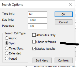

Possibly related, when using ldp.exe to replicate the LDAP search being done by DVLS, I noticed the tool locks up for a few minutes when I enable the option 'chase referrals'. Perhaps DVLS is also chasing the referrals and subsequently timing out or encountering some other error.

We tried a simple referral following technique that we thought might work. I will send you a DM with some debugging tools so that we can figure out why DVLS is not chasing the referrals, maybe as you indicated it's a timeout, but we can debug it and figure it out once and for all.
