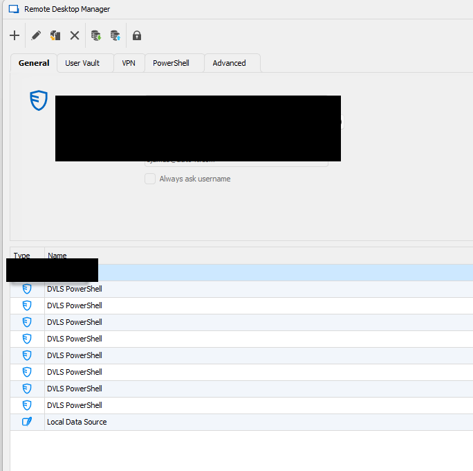

Strangely, I went in to data sources in RDM and it has this - not sure if this provides a clue?
Hello,
I noticed in your authentication script that the new data source is being saved twice. This happens first with the 'SetDataSource' parameter in the 'New-RDMDataSource' and again with the 'Set-RDMDataSource' call. You can remove those calls if you do not want to create a data source each time.
$ds = New-RDMDataSource -DVLS -Name $dsname -Server $dsurl -ScriptingTenantID $appkey -ScriptingApplicationPassword $appsecret -WarningAction SilentlyContinue
Set-RDMCurrentDataSource $ds
Additionally, I observed the use of the 'WarningAction' parameter. Could you please clarify which warning message this is suppressing?
