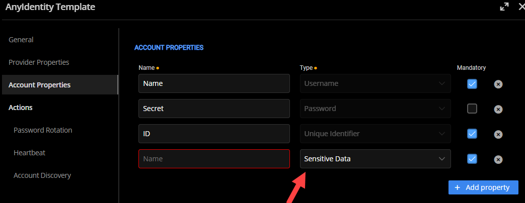

After adding a Sensitive Data type property to an AnyIdentity provider account attributes, the property can be populated when adding the credential to a PAM vault, but afterwards it cannot be viewed or edited using either the web gui or powershell cmdlet Get-DSPamAccount.

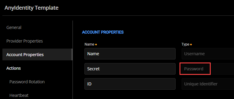

Any account properties of an AnyIdentity provider that are set as Password (sensitive) cannot be viewed afterward, they can only be replaced:

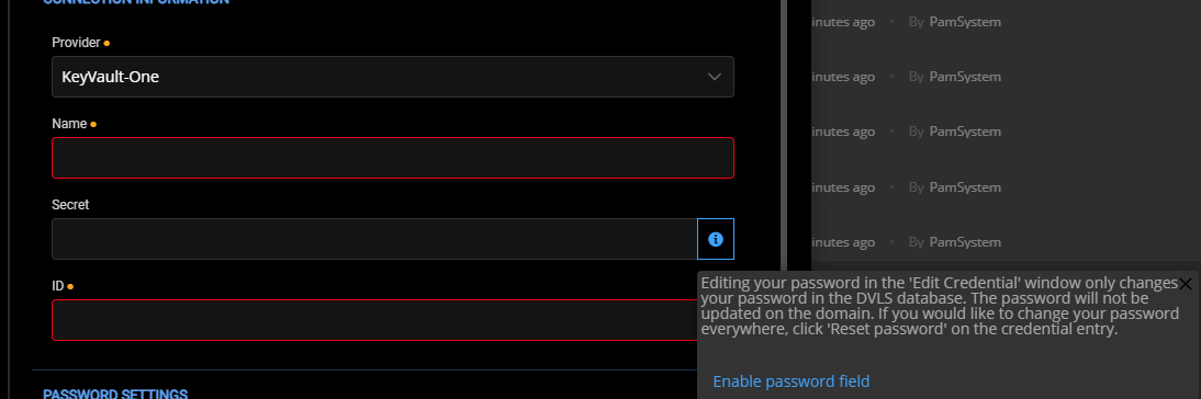

To modify the information, you would need to enable the password field, but it is only to replace it:

After discussing your issue with a developer, he mentioned that "Sensitive Data" is a different type than password:
That said, passwords and sensitive data are the same thing in the backend; it's just that you usually only have one password. This is only to specify that it will enter the script with a secureString.

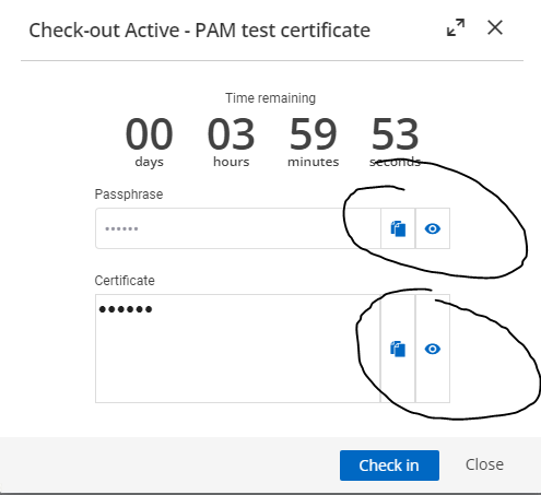

However, what is the purpose of having a data type of 'Sensitive Data' if it cannot be checked out and retrieved for use? I had expected it to work the same way the passphase and certicate properties are viewable after checking out the builtin PAM credential type called 'certificate'.
