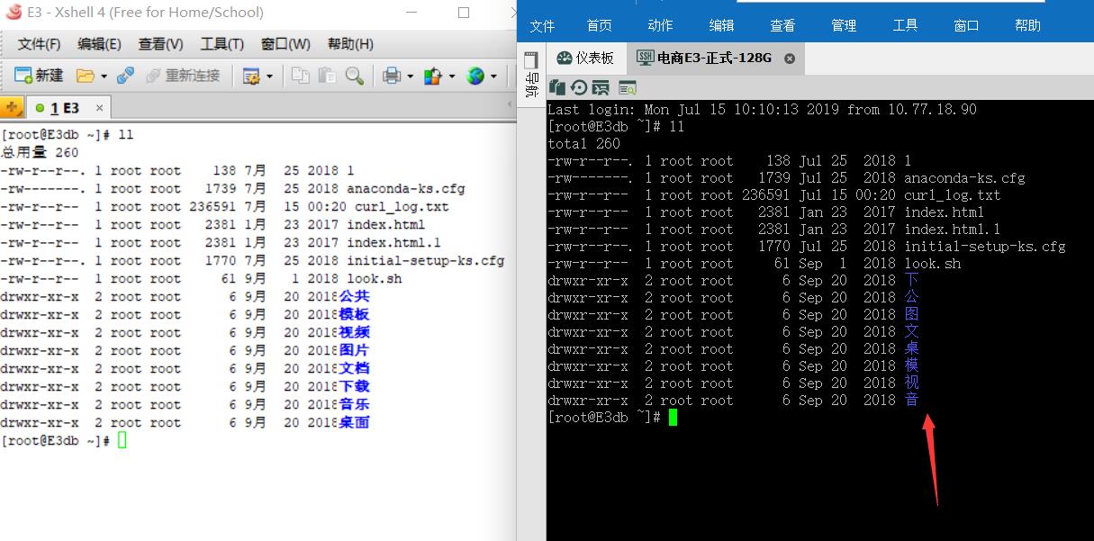

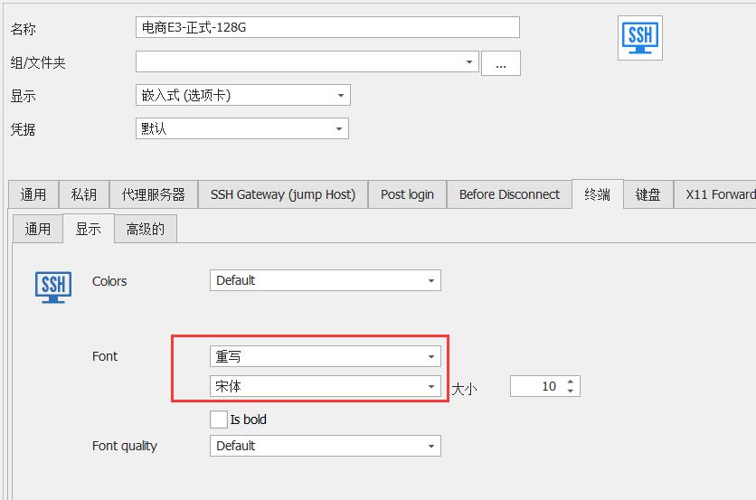

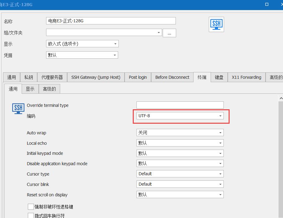

I have set the code to [UTF-8], and set Font to Chinese font[宋体].
But After I connect, I type [ll]. Some of my linux directory have Chinese, it is incomplete. One word is missing.
